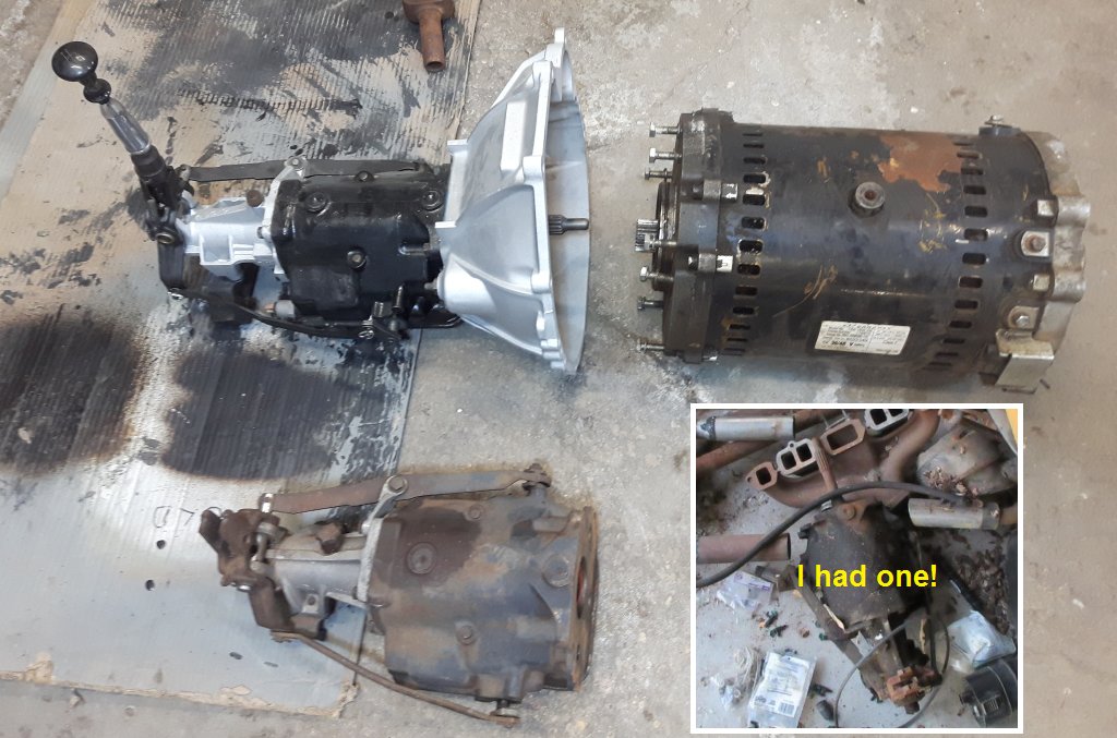

I should be more clear. The original driveshaft is going to slide into the original transmission tailshaft housing, onto the transmission output shaft. Like so:
Then, I am going to try to mate that transmission shaft to the motor shaft.
The transmission tail housing is going to mount to the back of the motor somehow (drill bolts, it's a 1.5" thick plate of steel).
Here's the motor next to a full transmission, imagine getting rid of the bell housing and the gear housing, and just putting the grey tail housing with a bit of a spacer ring, to the motor:
So, if my coupler shatters, it will mean that the motor is no longer spinning the transmission output shaft, but the driveshaft is still contained by 2" inside the tail housing and the tail housing still bolted to the motor. The only part that fails will be the coupling itself.
I'd consider that a "soft" fail with the consequences similar to a flat tire or running out of gas.

New milestone: I have now spent as much avoiding buying a coupler, to avoid buying a coupler, without having spent enough to actually make a coupler yet.
Well, time for an update on a series of failures that may someday lead to a success. Half of this is just so I have this written somewhere, it might not be that interesting.
There are 3 sub-projects to this, in increasing complexity:
1 - Make a mold of the driveshaft splines
2 - Make a furnace to melt the copper into a copper clone of the driveshaft.
3 - Make an EDM machine to use the copper clone to cut a female coupler out of steel.

Not having immediate success with buying a coupler, nor casting, nor EDM, I've spent some time laying out my options. Organizing my thoughts, not much progress to show.
1 - Hire a machine shop to fabricate a coupler.
2 - Fabricate a coupler myself, using a machine shop.
3 - Buy a Massey-Ferguson tractor PTO clutch to match the motor side, weld it to something for the transmission shaft.
4 - Continue with EDM experiments.
5 - Grind off/fill in the splines, make a taper-lock coupler.
6 - Weld the motor shaft directly to the transmission shaft.
7 - Wait for the forklift yard to maybe have a matching coupler.
8 - Carve a coupler by hand with a saw and file.
9 - Cast a coupler from aluminum or zamak.
And in detail why/why not:
- It'll get done right.
- It'll be the most expensive.
- It'll probably take some time.
- I have access to a machine shop with $50,000 of tools. A giant lathe, a manual milling machine, a Tormach CNC milling machine, etc. I'm trained on all the machinery, I can let myself in 24/7 and use whatever equipment I want, make as much noise as I want. No one else will be there at night I'll have the place to myself.
- It's cheating, on a simple project, to go use $50,000 of industrial machinery. Even more so to throw a piece in a machine and click a button and let the computer do it (which I could do, like, tomorrow). In as much as my project might be educational, this is the antithesis of what anyone else could get done at home. It's like commuting in a helicopter.
- I used to spend a lot of time there, don't have time to be there regularly anymore, and don't really want to remember how much I miss it.
- Ruining something brand new just for the splines.
- Kind of expensive.
- Still only a partial solution, still have to kludge the transmission half.
- Probably won't be very deep, (might need 2 couplers).
- My EDM machine has been on pause for 10 years, it would be nice to finish it and use it.
- I'm most interested in this.
- I've already sunk a bunch of time into it.
- Casting hasn't gone well but is becoming passible.
- Solution might not be sufficiently accurate. EDM has small, but existant air gap between electrode and workpiece by function of the process itself. EDM can be about 0.0005" accurate (half-thou), but that would be around a circumference so 0.001" total. Automotive fit is usually around 0.001" for sliding parts, so I would have to be at the limit of the technology on a home-built machine. This isn't a rigidity constraint like on a milling machine, it's a configurable attribute related to voltage, current and frequency, but the construction of my plunge die has to be within those tolerances for that to matter. Alternatively I could undersize my electrode to compensate, but that means I can't just cast an image of the shaft, I'd have to machine it smaller, making the whole process moot.
- I risk going off on a tangent project that will sink too much time (for example, as it already has).
- A taper-lock is just a barrel of aluminum with a narrow slot in it and some bolts to squeeze that gap (nearly) shut.
- It's apparently as strong as a weld.
- It's proven strong enough for DIY EVs in the past, it's the common machined solution.
- I don't like damaging the motor splines because I can't undo that later.
- I could fill in the splines with JB Weld and leave it large, it's just surface to squeeze on.
- 2" aluminum bar in short lengths is probably as much as a PTO clutch would cost, and I doubt my machining ability with steel.
- I could also/instead cut a keyway and use a keyed shaft. But I presume there's a reason that keyed shafts are never used like this even though that's simpler and easier.
- Shaft is permanently damaged if I screw it up.
- Can I create a jig to weld it sufficiently square and centered?
- Solution in general is pretty permanent, most other solutions I can just abandon and try something else with no consequence.
- It limits serviceability or making other changes.
- This has always been my backup plan, and tempting.
- Forklift yard mentioned they have 2 more machines like the one I took the motor from, that they're combining into one. They'd pull the gearbox for me so I could recover the matching splined shaft. Though they're not sure when, or if they have a buyer for that. Or time to do it.
- This has been my backup plan for a while, knowing it might be "a month" or more, but, it's been 6 weeks not no call yet so, probably won't happen.
- I have no idea how long I might wait for that to happen.
- Is still only half a solution.
8 - Carve a coupler by hand with a hack saw and file.
- Seems like the worst choice, but it's so, so simple, and unlike welding, not a permanent commitment. It just takes time. And honestly not that much time compared to fancier solutions.
- I've done it before, and it worked then.
- I hate this.
- Instead of casting the female image in a plaster mold, then pouring copper into this mold to create a male image, then using the male to EDM out a matching female, instead just cast the female directly.
- Make a silicone mold of the splines, use that only as a shape to pack a high-temp sand mold, pour metal into the sand mold.
- Aluminum has a lower melting point than copper, so if I could cast copper I can easily cast aluminum.
- Zamak (Zinc/Aluminum) is stronger than bare aluminum, melts at a lower temperature, and is considered "zero machining" surface finish quality.
As much as I hate throwing away my casting and EDM efforts of the last 6 weeks, and I'm confident it'll eventually work, I'm worried that I'll get it working but it still won't be good enough regardless of my effort because of physical limits. I guess it's time to put my EDM project back on the shelf.
I think I'm going to try casting a Zamak coupler. A car guy's suggestion of using silicone mold to cast tin (no good) gave me the idea that, the only reason I can't cast a female directly is because I don't have a female mold. A plaster mold wouldn't survive being used as an image, but silicone would be fine to pack sand around and then remove.
If that fails, Plan B is an aluminum taper-lock.
If that fails, Plan C is to just weld it up solid. Or braze it so there's less warpage.
