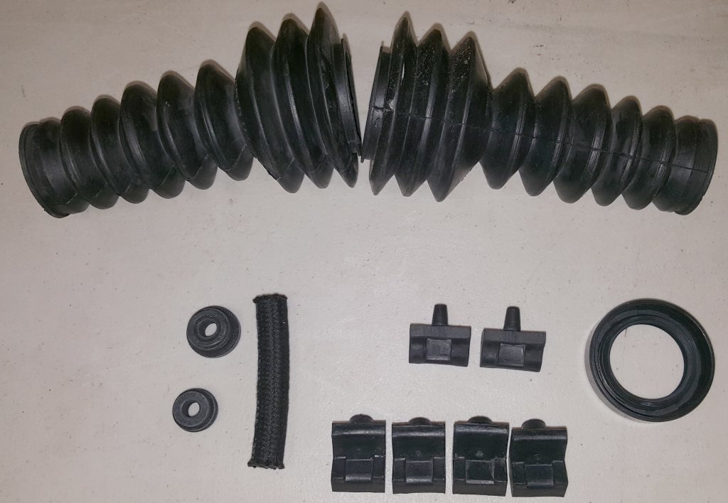

Misc:
Brake lines and fittings arrived. Went with the teflon coated one because it was the only 3/16" line on Amazon Prime. $17 line, $13 fitting.
Snuck in at the tail end of the Covid sale at the Opel shop for about $100 of stuff:
- Door bumpers
- Hood bumpers
- Steering rack boots
- Master cylinder reservoir seals
- Master cylinder hose
- Rear transmission seal

Order arrived from the Opel GT supplier in the US. My shopping cart had a few hundred worth of stuff during their Covid sale, but it paired down to $58 by the time I ordered. I expected shipping for 1lb of little things from the US to be like, $10 at most.
I guess I wasn't really thinking, I don't need any of this stuff now and the savings from the Covid sale (after I pared it down) were completely swamped by the shipping costs of ordering now.
Even combining shipping with someone else local, a 4lb box was $48 (US) shipping + $18 CAD in duty. $80 CAD to ship 4lbs to Canada. At least we saved money by splitting that to ~$40 each, but, ugh. This is why many Canadians just ship to the border and then go pick it up themselves. If you don't mind the drive, even small orders cost as much as a tank of gas.
Anyway, mmmm, the smell of new rubbers:
- Steering boots
- Master cylinder tube
- Door and hood bumpers
- Transmission output seal
