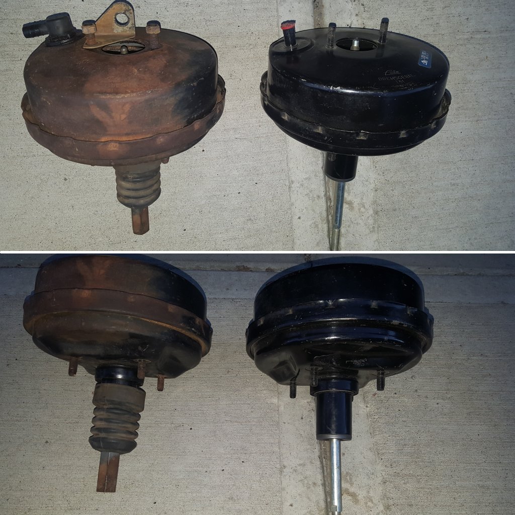

The Opel GT brake booster sits on a weird 2 foot long extension at the front of the hood, to get it all the way past the entire engine, for space constraint reasons:
And my brake booster is in questionable state of functioning (it holds pressure, but I'm skeptical, as I mistook a large hexagonal seal for a plastic bolt and spun it way too many times). And, my replacement brake booster isn't from a GT, it's from a Manta, which has a different pushrod:
I think I've mostly decided not to keep the booster in its original janky location.
So that means I'm likely to choose between relocating the brake booster, and switching over to the Manta one (with a vacuum pump), or, using the iBooster (with a fabricated master cylinder).

First challenge now that the body is "done", is fitting the brakes.
Brakes on the GT are... unique. Everything under the hood on the GT was a compromise and an argument with those that wanted better performance vs. simpler and cheaper. Everything is packed in there in weird places to get the engine as big as the engineers wanted, and as far back as they wanted. That's why it has the hood blister (only place the air filter could go, wouldn't fit flat under the hood).
Instead of having the brake booster mounted to the firewall like every other car, it's 2 feet forward, ahead of even the radiator. When you push on the brakes, it moves a 2 foot long pushrod and finally actuates the brake booster at the nose of the car.
A reminder, this is what the brake boosting setup looks like:
This is silly, I don't want this, and I don't have an engine to worry about.
I have two working brake boosters, but I don't want to use a loud vacuum pump, so I bought a Bosche all electric brake booster for $75 CAD out of a 2017 Honda CRV. You connect 3 different 12v+ wires, and a ground, and that's it. No CAN, nothing fancy.

Looks like that'll work! Presuming the master cylinder can be flipped, and, it looks like it can (2 mounting bolts that are radially symetrical). I can't think of why the orientation on booster would matter, so, should be good.
Next problem, the push linkage is too long. I'm bottomed out against the brake pedal, with the booster 2" away from the firewall (connecting the linkage pin maybe lowers that by 1/2").
Brown Wood Water Helmet Hardwood
I don't really like the idea of modifying the pushrod, but I guess I'll have to. That, or awkward standoffs into the engine bay, which might drive the booster into the wheelwell again.
Next problem... because it never needed a booster mounted there, the firewall isn't flat or vertical. It's not just angled backwards, it runs into a 30 degree fold in the firewall. Also, the damned steering shaft is probably in the way if I were to mount it square, so I might have to mount it tipping upwards to match the flat of the upper portion: That might be a problem, can a master cylinder run at a... 10-15 degree upward angle? It must sort of be able to, since you go up hills, but, to what degree is that a problem if any?
Gas Auto part Screw Metal Motor vehicle
