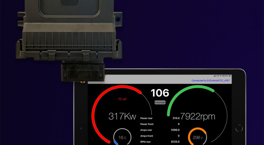

Hi Everyone,
I'm wondering if anyone has experience or advice on controllers for the Model 3 rear drive unit for an EV conversion. I'm aware of two options:
Ingenext:
and EV-controls T-2C:
Both have some minor pro's and cons for convenience (programming over iPad vs PCAN) and price although the cheaper (ingenext) needs me to send the inverter so that might work out neutral in the end.

I don't see the EV Controls app in the App Store. Got a link to it?
Yeah I found it in the documentation. Says it is not compatible with my iPhone. But seems to work on my iPad.
