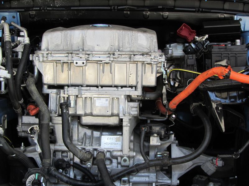

Sure, I just pulled most of the batteries in preparation, so here's a few pictures of the current state of the vehicle. Thanks for the reply!
Sent from my iPad using Tapatalk

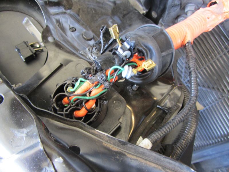

I have had a busy week with Finals and my daughters birthday so I have not been very productive on the project. But here are a few pictures to show where I started and where I am at with the 2013 Leaf so far:
As you can see, everything in the front of the vehicle was smashed up against the inverter/charger. My concern was the extent of damage to that area, as I hope to eventually utilize it all in my conversion.
It was immediately apparent that the J1772 Socket took quite a blow.
After finally separating the charge door from the rest of the mess and cutting away some interference, the socket face appears reusable! I may get away with being able to re-pin the socket, and call it good.
I was relieved to see that that the drive assembly appears to be undamaged. I then plugged a few things back in and went for a test drive. The vehicle gets around just fine, no apparent grinding or strange noises. I did floor it and was only able to get up to about 20MPH. I assume the turtle indication on the dash would explain this.
Next, I think I will clear up some room in the garage and drop the battery pack.

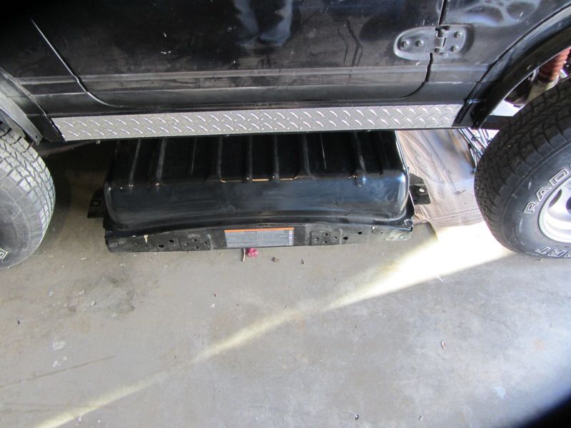

Dropped the battery pack from the Leaf today. It didn't take too long and I still have my arms and legs! Aside from pulling through the HV cables from inside the vehicle, there is not much I can do with the Leaf until I get my hands on a cherry picker for the motor assembly. I may look for a pinout for the J1772 Socket and re-pin that. In the mean time, I will focus my attention toward fitting the batteries in the Samurai.
https://youtu.be/GrxmF56TGls
120 Posts
I got a bit overzealous today, and while lifting the cover off of the battery pack, I lifted from the non-connector side. Unfortunately the cover slide off the backside, and somehow was able to catch on the communication port... breaking the plastic housing! :eek:
Luckily no pins were broken. For now I will leave it covered up with electrical tape. Fail. On the bright side! the cover is off, and I can now start test fitting the batteries in the Samurai.
I was able to re-pin the J1772 Socket as well today, so overall it was a relatively productive day. Throughout the week I plan to break down the battery pack and hopefully use as much of the existing wiring a possible to fit the pack into the Samurai. After chasing some cableway throughout the Leaf, I think I am better off looking biting the bullet and forking over the money for a Brusa Charger.
Until then the Leaf pack has found a safer, and rather convenient storage location:

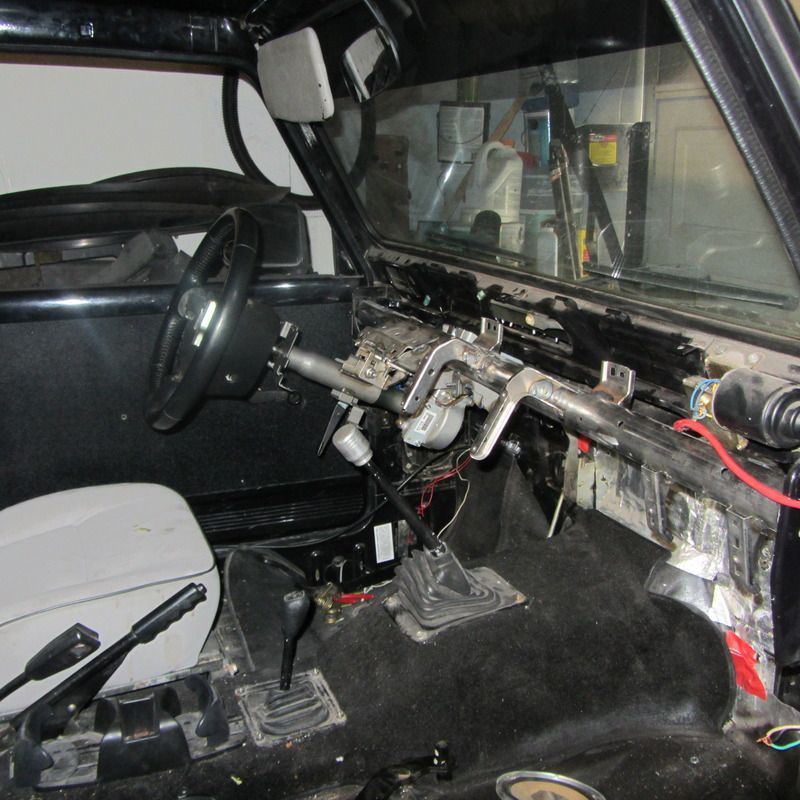

Work has been getting busy so time has been limited on the project lately. My current focus has been trying to integrate the electric power steering from the Leaf into the Samurai. The challenge has been Realestate. I still need to maintain use of my clutch, brake and current throttle. ( at least until I figure out how to integrate the Leaf's brake assembly.)
Heres my progress so far:
I just need to weld a couple more support brackets, and bolt everything in.
From the picture you can't tell, but I still have enough room to fit the brackets for the clutch pedal, and brake pedal.
Until next time!

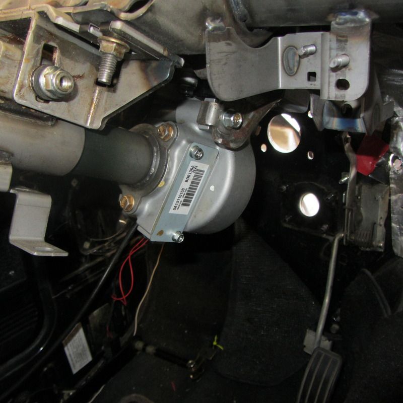

Although I have been inactive on the forum lately, I have still been tinkering with the car. The brake Master Cylinder is in! It turns out that if you remove the adapter plate attached to the Master Cylinder, it slides right into a Suzuki Samurai! The adapter plate was cut down on a band saw to create a spacer. I then cut off the brackets on the Regen Pot, and welded them onto the brackets for my clutch/brake.
You can also see in the picture that the intermediate shaft from the power steering to the gearbox turned out quite well. I added a bearing collar in the firewall to help prevent any play/vibrations.
