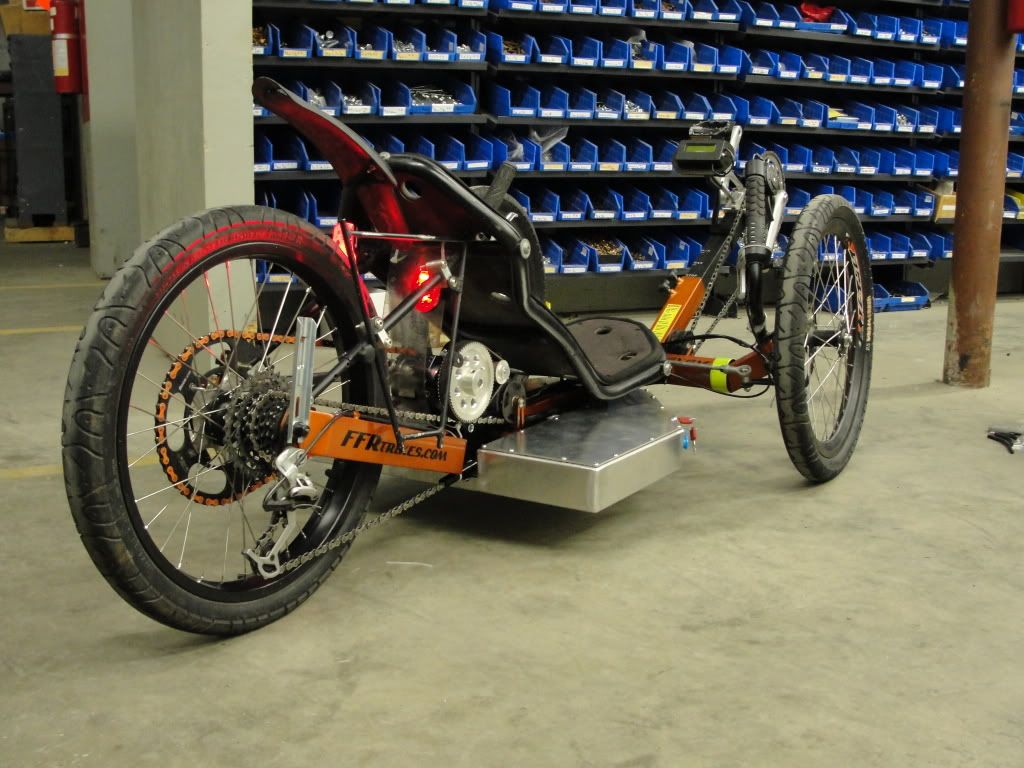

Ok, so the EV trike ain't gonna work, not yet anyway.
So on to the next idea.
Recumbent pedal trike,
Replace the chain drive system with 1 or more hub motors,
Fit a smallish battery and other gubbins,
Possibly connect a dynamo to the pedals.
Thoughts please.

Yep, a recumbent trike would be good. I bought a KMX with a broken back for just that purpose. I rebuilt it but have temporarily misplaced a little electric bike motor I put aside for it.
If you are looking for it to be road legal then I think there are limits to the maximum continuous power output you can have, something like 200W for a 2 wheeler and 250W I think for a trike but I will check. There is no limit on maximum intermitant power though. ;)
It must only be able to power up to 15mph though.
Also in the UK, unlike in the EU, we can have the bike or trike powered without pedalling, that makes control easier and also more fun.
You can replace the drive train with a generator and a motor but you will get diminishing returns. However you can keep pedaling even when stationary, or when parked up at home, to charge the batteries but it will be harder work.

Ahh, in that case powering an electric drive system shouldn't be a problem. I reckon it would be a good idea but you will be limited to 15mph by law.
Keeping a chain drive will allow you to keep pedalling above 15mph even though the motor would/should have stopped assisting.
If you were to go above 15mph or 250W for a trike (or tandem and 200W for a bike) then you will fall into constructions and use regulations for motor vehicles and it becomes a moped requiring better suspension and brakes, insurance, MOT, road fund licence and a helmet. Also the age limit, which won't apply to you raises from 14 to 16 or 17 depending on power and top speed and will also require a suitable driving licence.

If you are doing a recumbent trike how about a legal rear wheel hub motor and two higher output front wheel hub motors for 'off road play'?

The controller is a black box of electronics that 'chops' the DC into pulses. The pulses are then width modulated so that the square wave that comes out equates to a variable DC voltage as far as the motor is concerned. The throttle is simply a variable potentiometer that tells the electronics how the pulse is to be modulated.
Small pulse wide gap and the motor runs slower, wide pulse small gap and the motor runs faster. The pulses are usually around 5-15khz and so have to be protected from causing RF interferance.

Well, Pulse width modulation (PWM) is an effective way of varying the DC voltage. Unlike with AC where you can use a transformer to change a voltage DC is difficult to change and so the motor is 'fooled' into thinking the voltage is lower by pulsing the high voltage so that the mean voltage going to the motor is lower. That then allows the motor to run slower and be speed controlled.
The other way to control a motor speed is to use a variable resistor so that some of the voltage is dropped across a resistance before it goes to the motor. The trouble with that is that power is also lost to the resistor as it gets hot and that is a waste of valuable battery capacity.
