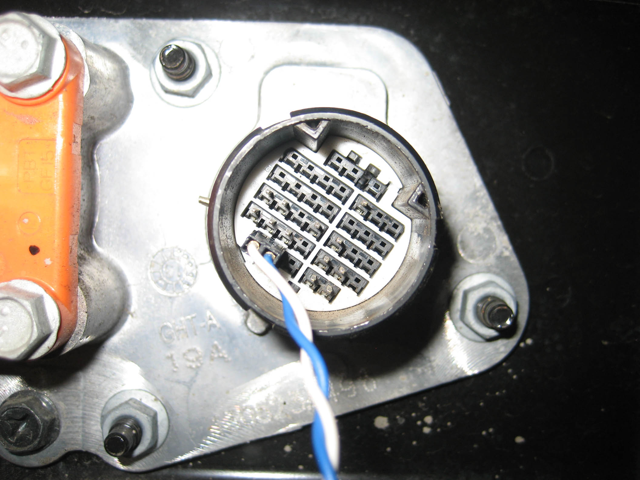

But I have not been able to source the round connector (22 pin on the 2012 and earlier, and 36 pin on the 2013 and later) for the battery pack...
So I have been thinking about making a few without the connector for those that want them... But I am not sure how useful they are unless you already have the connectors.
You would have to plug in wires like this:
1,433 Posts
3d Print it. And glue in the "normal" single row 0.1" female headers.
Must be the easiest option
I don't have a 3d printer...
But, I like that Idea...
I wonder how hard it would be to make a 3D model...
Would just need to be a cylinder with a two notches in it, and cutouts for the 4 female headers... :)

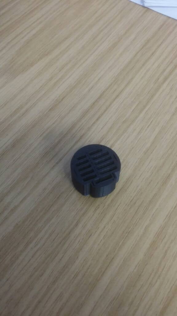

We use Solid Works here, at work, and I think I can get one of the mechanical guys to model it.
I will bring in the connector and female mates tomorrow and see what happens. ;)

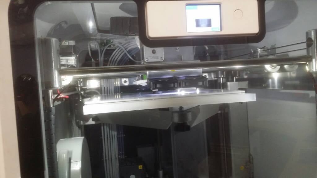

We have a FAB LAB over at the University that lets you 3D print and pay by the hour/material you use. So I think this is a really good solution to a hard to get connector. :D

Gen 1 or gen 2? Have one of each here. If you can make the file available i'll prknt one out here too.
Sent from my SM-N9005 using Tapatalk
I wanted to print it first, might need to tweak the centering and the openings for the connectors, before posting it...
But if you wan to try it out and give me feedback on it, I can make adjustments to it while I am still at work. ;)
