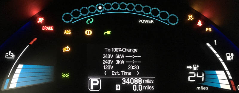

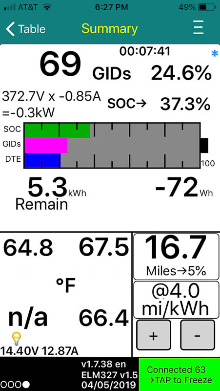

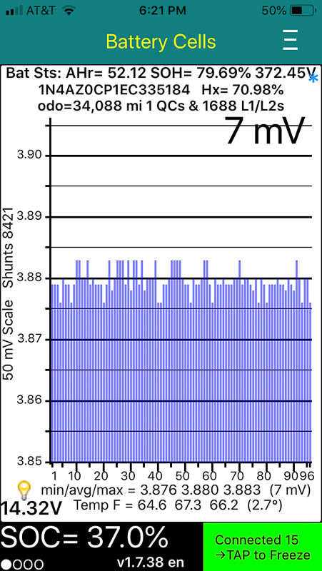

Well, the Leaf showed up, and it seems to be in good condition. It drives on its own and has been plugged in for the last few hours. Seems to be charging and balancing pretty well, with no bad cells that I can detect. Water pump is whirring away, and it even came with a fast charger and nav.
When the car arrived, the traction battery was probably sitting at 5% for weeks. I was lucky to get it into my driveway before it refused to move. I think the battery is at about 80% of new capacity, which will work for me. I wonder if it has the "lizard" battery (which is rumored to have been quietly phased in starting in 2013).

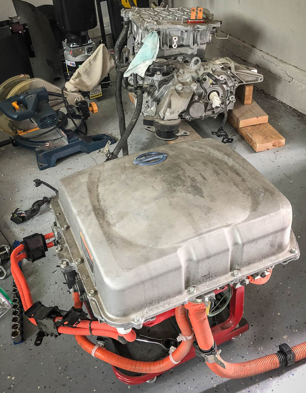

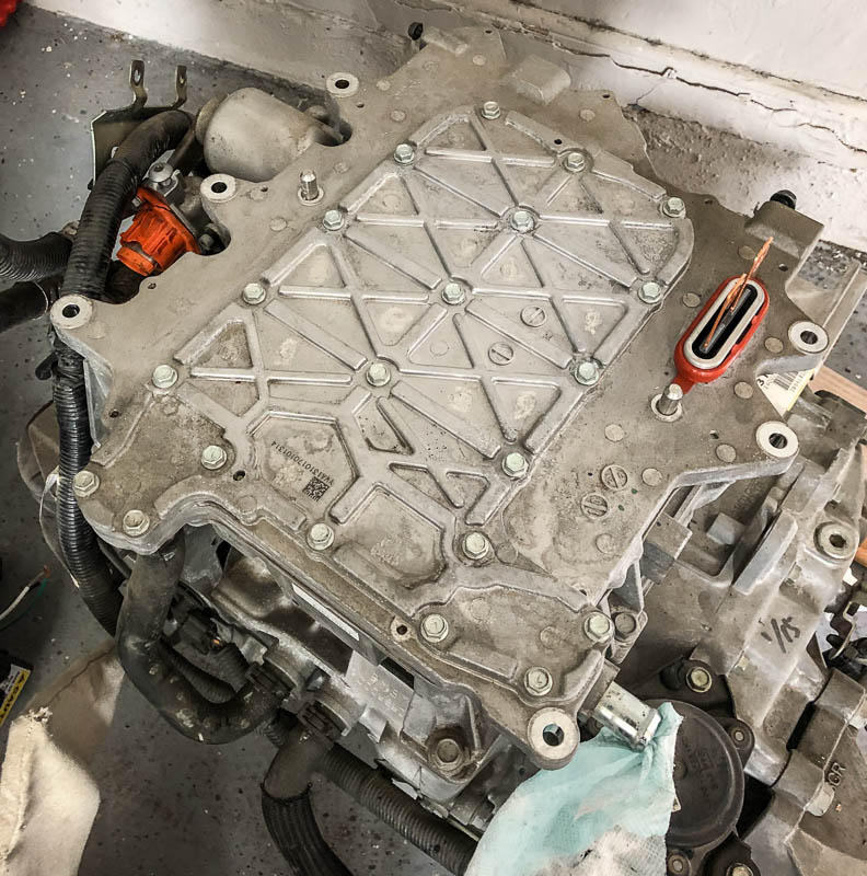

It's a neat car! Under the knife it goes! Phase 1 is to try and get the motor spinning on a bench...Phase 1a is figuring out everything I might want to pull from this Leaf before I put it up on eBay...
LeafSpy app screenshots:

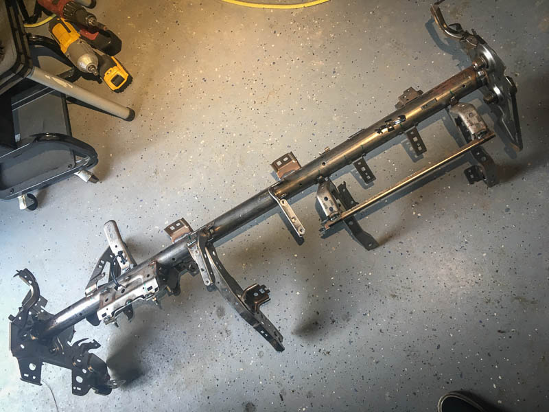

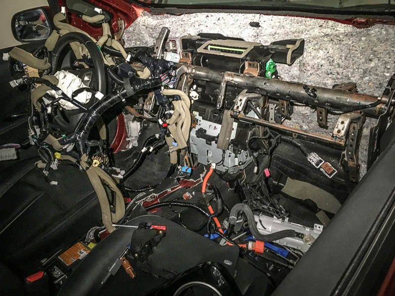

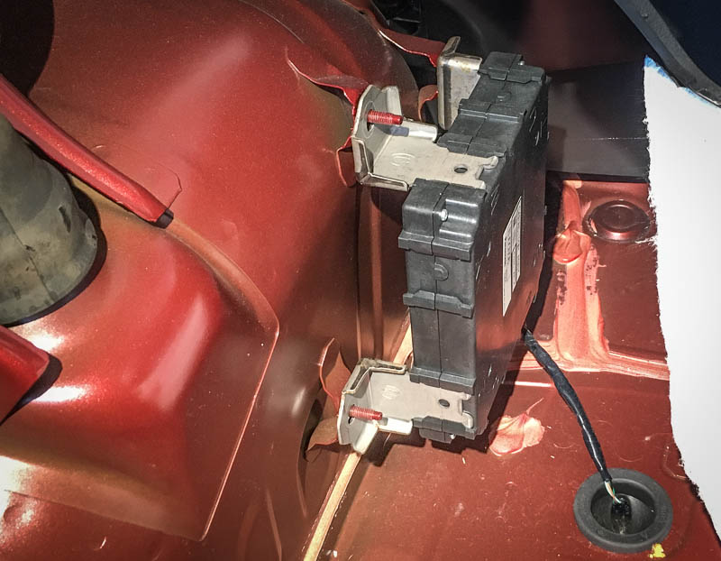

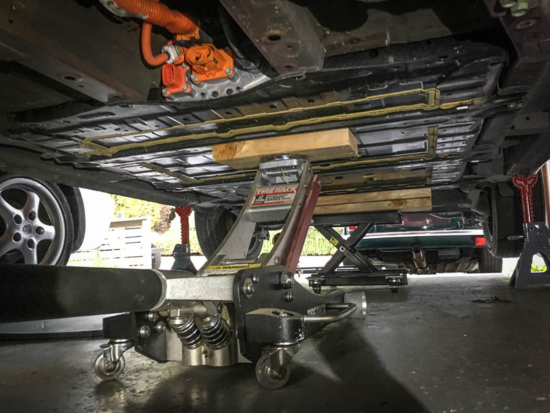

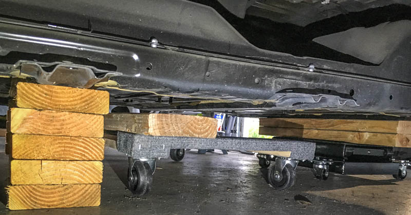

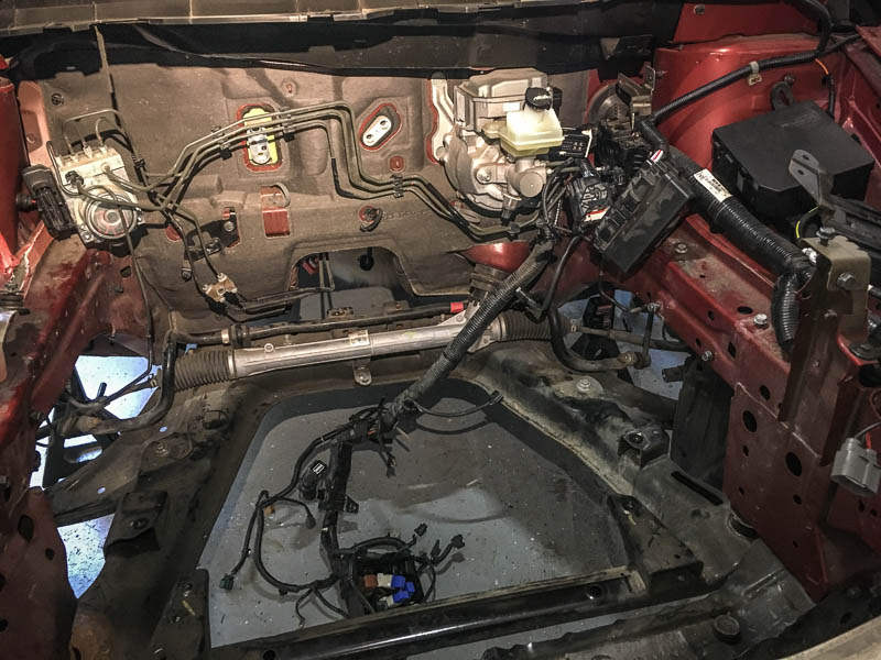

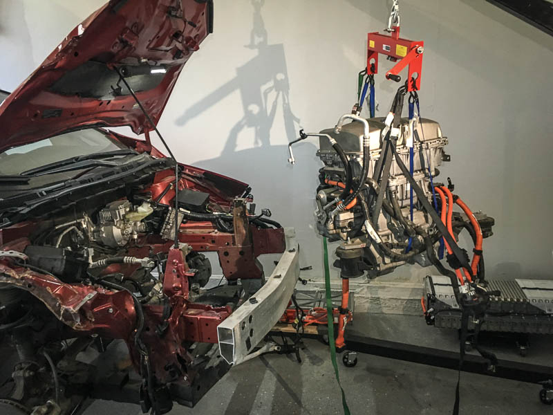

Some progress. Teardown is pretty straightforward. You just...pull stuff off. The hardest bit is freeing the wires and connectors. I used the Nissan dismantling guide for some, and the factory manuals posted earlier are very helpful for figuring out how things go together and come apart. Now is not a bad time to drain the coolant from the motor and radiator.

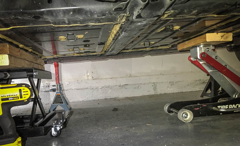

I managed to get the battery sled out by using two jacks, slowly lowering each side an inch or two, one after the other. The rear jack is a motorcycle scissor lift that came in handy due to its wide base and castors. I more or less did a variation of this guy's triple hydraulic jack approach. It goes faster with a friend.
Next challenge is to figure out the easiest way to unstick the battery sled cover...and I also need to figure out how to remove the axles from the gearbox...and a bunch of other things, but...

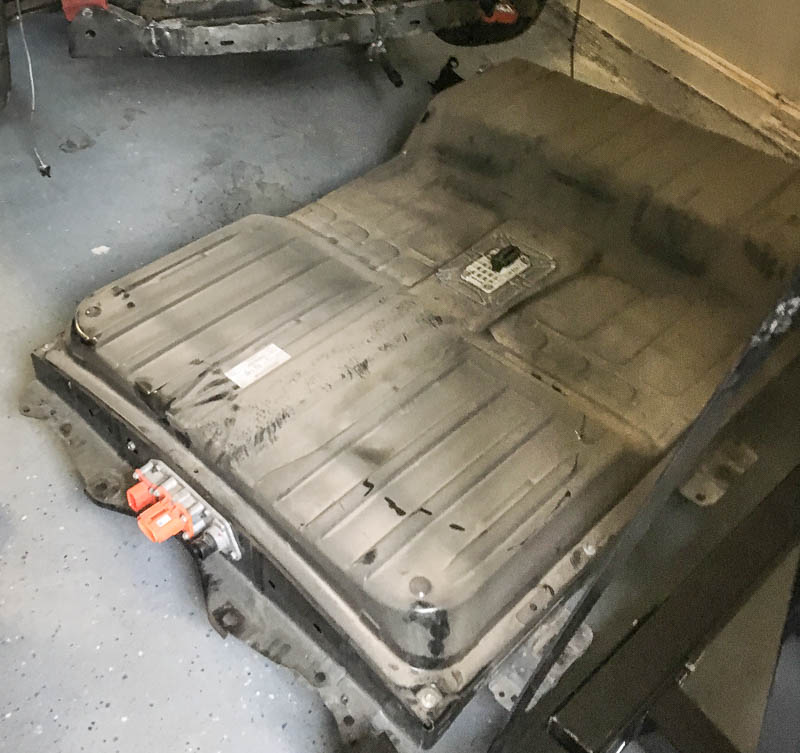

660 Posts
The gasket seal on the 2013+ battery covers is a monster. If you're looking to tear one down, a multi-tool will be your best friend.
This was helpful, though he does not demonstrate how much work is involved in releasing that gasket:
https://www.summet.com/blog/2015/04...san-leaf-battery-pack-and-remove-the-modules/
I attempted to use my shop crane to simply peel it off from one corner, and it ripped through the eye hole before it even budged. Then I tried a hammer and a chisel with some success. Then I tried an air chisel and it was worse. Then I looked up "power spreaders" and "gasket knives" with nothing promising...then I remembered my multi-tool.
It's not a slam dunk; it still took me an hour or two. The best method I'm aware of is:
1) Go around the whole cover and pry up the lip so there's ample room for the multi-tool blade.
2) Apply some upward pressure (if you can) to prevent the multi-tool from getting bogged down between the rubber as it cuts. I used my shop crane, but a floor jack and some S-hooks would do it. It just helps spread things and improve visibility.
3) Like when cutting something a bit thick with a razor blade, do several "light" passes as opposed to trying to cut through the whole gasket at once.
4) Leave one long side intactyou'll be able to clam-shell it with three sides free.

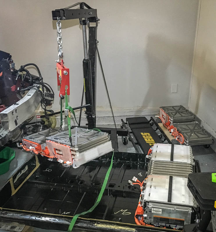

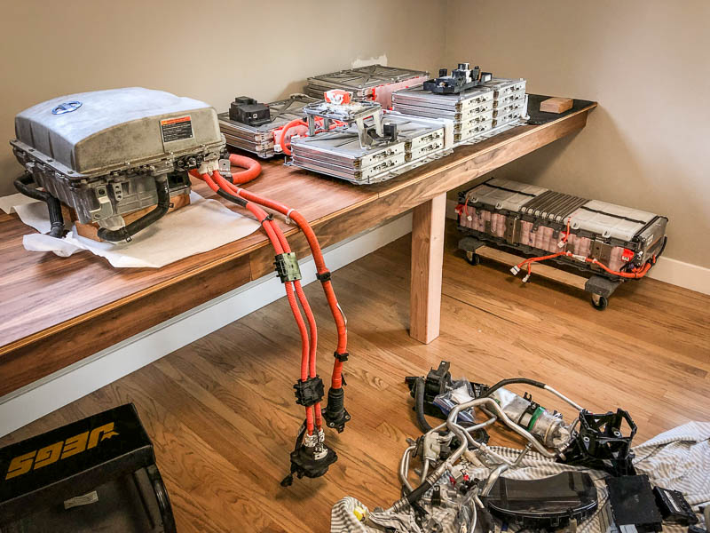

Bit of progress. I got the main module packs out with the help of a shop crane and some dollies. Disassembly was reasonably straightforward with a pair of high-voltage gloves and docs/videos of others who have done it. The hardest part was the cabling clips, really. They can be tough to get to, and there are two kindsyou'll have to take a look behind to see how to release them. I don't know why I didn't just pry them all out, but I'm trying to exercise patience with this project...
Does anyone know how to tell if this is the "lizard" battery pack? I couldn't find any info on it.
To save me the hassle of removing a bunch of components that I would have to put back on, I'm just gonna cut the axles at the wheelI'll only need (at most) one side anyway! Hopefully they'll pry out of the motor side fairly easily, but that is yet to be seen...Not much info out there on this bit, as I think most drop the front subframe. After reading about the procedure in the factory manual, I don't want to go through all that...I'm just gonna free the axles, unbolt the motor mounts, and yank it out the top.

More progress on the "easy" part...I cut the axles and they pried out of the gearbox easily. I dunno how I'll mate them to the Mini wheels, but I'm hoping the answer lies under the rubber boot. Once everything was out of the engine bay, the motor lifted out with ease. I've pulled my first motor.

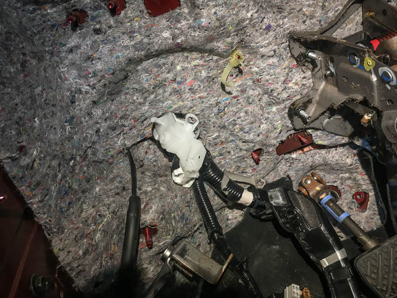

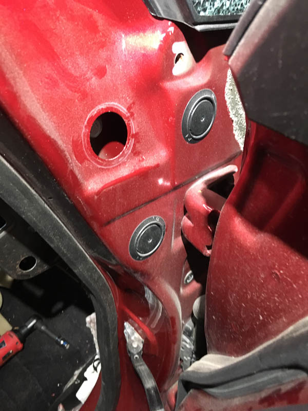

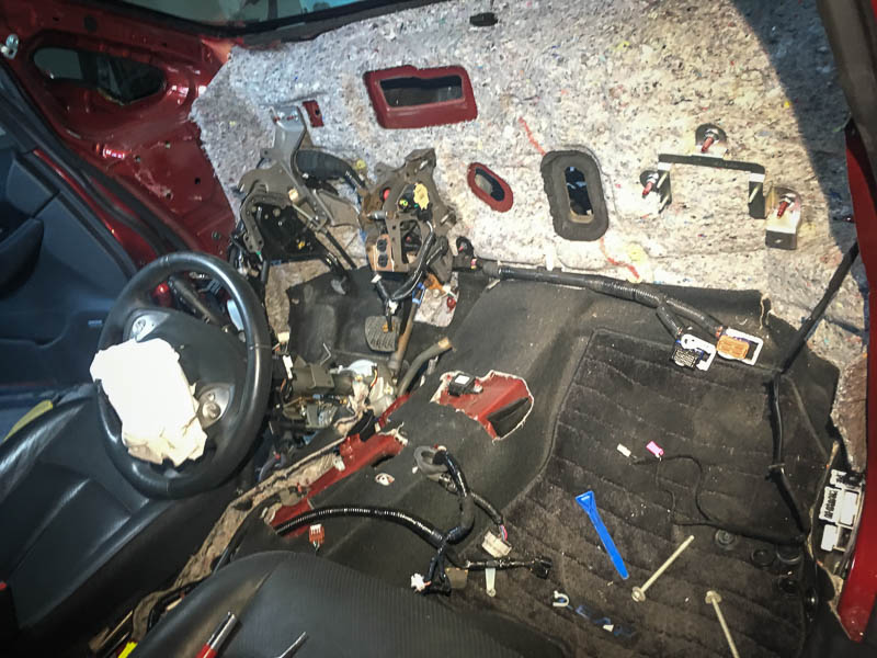

The hardest part of this teardown is dealing with the wiring harness. I've never seen so many wires, clips, and connectors in an automobile. Very few major components are actually detachable such that it looks like I'll need to take apart the entire dashboard and center console, disconnect everything, then fish the whole nervous system forward through the hole in the firewall. I wish I knew what was unused and safe to cut off.
The prospect of getting all this stuff in the Mini is proving daunting. Progress?

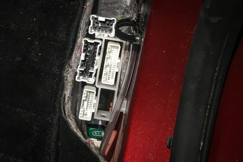

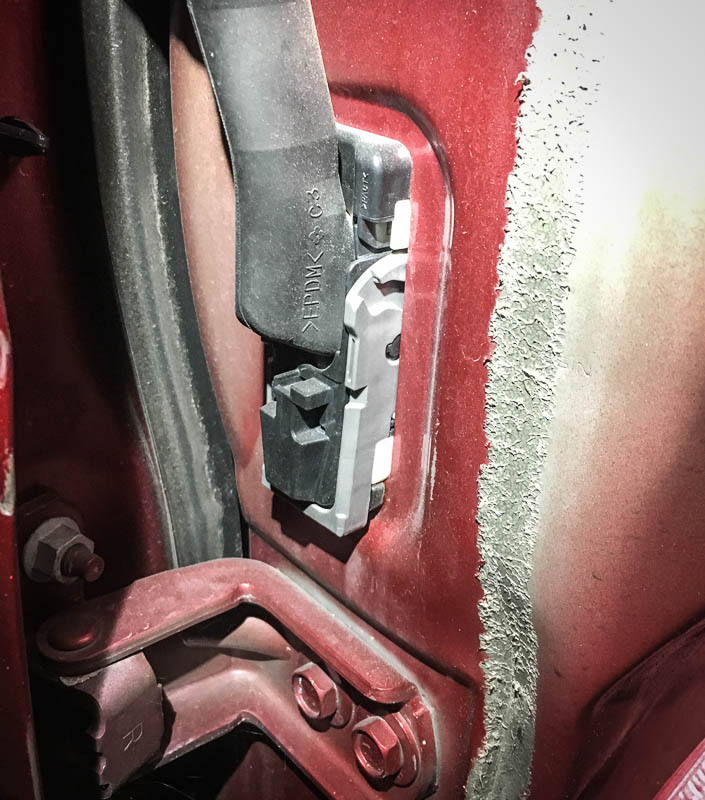

How much of the dashboard did you have to remove to get the electrical out? We're you able to do it without taking the doors apart?
Daily: Tesla Model S, EV Build: The Magnificent Favelec!
657 Posts
I'm following with interest, keep up the good work. :)
It's going to be a very tight squeeze getting this lot into the original Mini! Are you planning to turn it into a 2 seater to make more room for the batteries?
266 Posts
I took my dash completely apart because I wanted everything out of it so I don't know the minimum. The doors have connectors so you likely won't have to take them apart. I did everything without removing the doors from the chassis, too.
