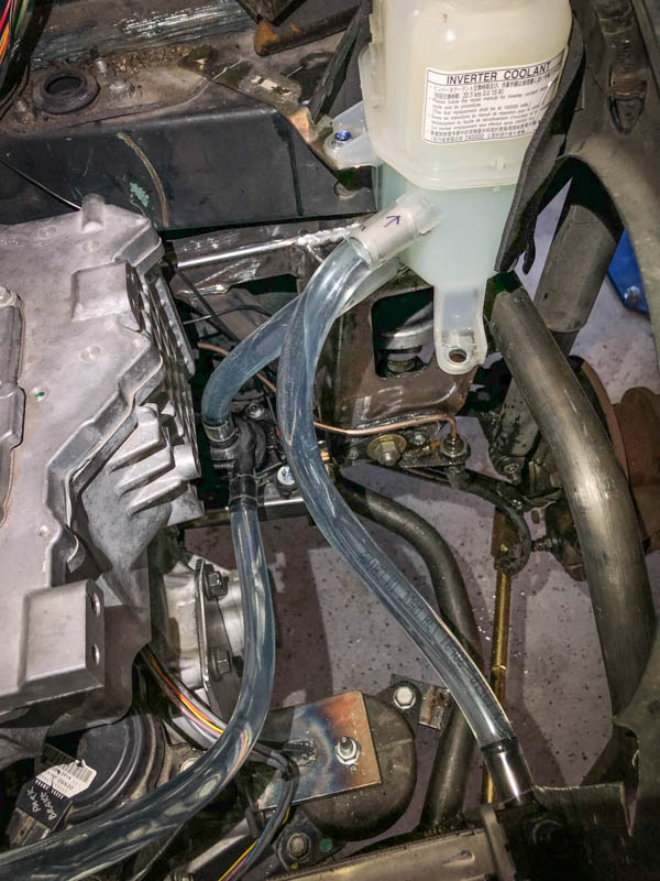

The cooling system is flowin'! The Prius pump is strong, nearly silent, and only has one moving part. The system purged itself of air bubbles rather swiftly.

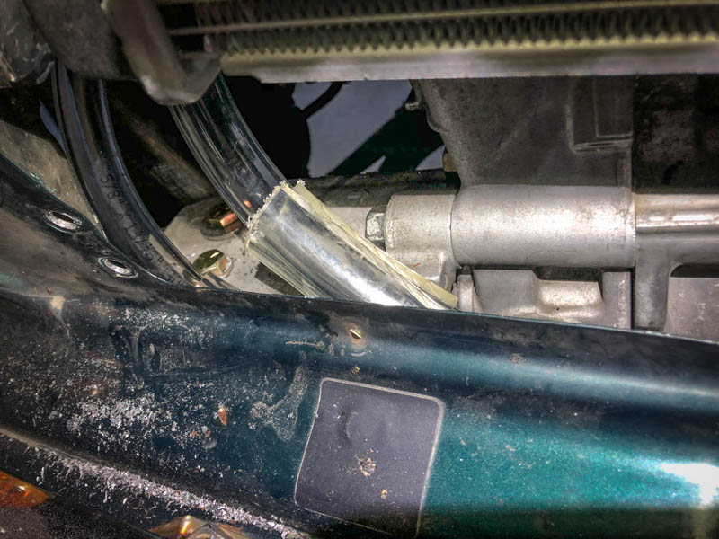

I ditched the 3/4" ID tubing, as it was kinking too much in front of the motor, and in the end was unecessarily large—I managed to get 5/8" ID tubing over the Leaf ports with a heat gun and some soapy water as lubricant.
I used PEX elbows to avoid any tight bends (3/4", but PEX uses a different sizing system), but they may not have been necessary after downsizing the tubes. They seem to be as good as steel and as cheap as plastic. The tubing might be too loose on them without clamps, but I'm gonna give it a whirl.
There was very little room on the left, so I wound up just stuffing the two tubes from the motor through an opening and wrapping them with more tubing as protection. My plan is to just keep an eye on things to see if the protection falls out, or gets damaged too quickly, or what. Getting tubes to the motor was very annoying, and it seemed like any useful cutting of the body would be visible.
I didn't have the Prius water pump connector, so I just filled the sucker with Fluid Film to prevent moisture from shorting anything out...I don't love it, but I'll wait and see before trying to find a connector.

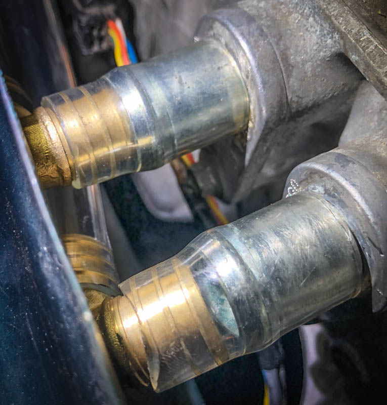

I definitely wouldn't trust PEX barbs with soft hose of any size without clamps. Even with PEX clamp rings are needed. With clamps, they should be fine, as long as the tubing inside diameter (before stretching) is smaller than the barb outer diameter.

1) I'm leaking coolant from the PEX fittings. When the coolant goes over 100°F, the tubing starts to get soft and drip from where it exits the motor. I'm gonna clamp 'em. I'm running tap water at the moment, so no biggie. The motor has been staying around 110°F, and sometimes gets near 120°F under load. I'm not sure what to expect when the car is parked in the hot sun and then gets floored...Worst case, I'll ditch my fancy clear hoses, but I like them! My "overheat" temp is somewhat arbitrary, cobbled together from Internet research...I've seen 160°F and I've seen 200°F as inverter maximums, so I dunno. My hoses are specced to 150°F...
