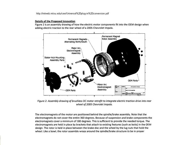

Hi Everyone,
Just joined but been following ideas for a while
I spoke to Dr Charles Perry Mid Tenersee State University (MTSU) last month who is heading up the project on the in wheel motor and he's run into problems hence no news since July 2012. He's of the opinion that the motor needs to be a switched reluctance motor (SRM) as with any DC/AC motor with magnets you get back EMF (?)i.e. increased drag/fuel consumption which you don't get with an SRM. He's looking for funding (around $250,000) so if you know anyone?
Also I have spoken to Protean (I am based in the UK and they are local) and they are not interested in talking to anyone with less than a fleet of vehicles. I'm in touch with a Chinese outfit http://www.evmotor.net/kg/eng/index.asp and they have a motor for $1550 then you need the controller. I am reluctant to purchase 2 for testing for reasons already given by other members (overheating etc) so if anyone has an update on reliable and lower cost motors I am interested. My project is a Toyota MR2 which I am planning to convert to a small diesel with electric motors. At a recent Hannover Messe they were demonstrating the VW XL1 which does 314mpg - all current technology - 800cc engine +24hp electric motor
Thanks for the link Freddy. I think I may have to try two of those Chinese Units to put into the rear wheels of my '01 VW Jetta TDI. It already gets 45 mpg highway, I may be able to get my canyon driving numbers up a bit with some E-assist. Or maybe a motorcyle?
I think MTSU should launch some sort of crowd funding effort to get their project off the ground. Who knows, I may try to find the time to help.

Hillbilly & freddy,
You're wasting your time. The MTSU motor is a joke. Read this thread: http://www.diyelectriccar.com/forums/showthread.php?t=20591&highlight=wheelmotor Too bad that a lot of the photos are gone from it. But it still should be informative and amusing.
major

Thank you major but I do not see any reference to MTSU in your link - If you have useful information about this motor then please share it - have you spoken to Dr Perry and voiced/expressed your doubts to him? MTSU is not the only in wheel technology organisation I am in direct contact with. Are you talking to any? The world is full of tyre kickers and cynics, I hope you are not one but are able to bring positive and constructive information to the forum. So please qualify your comments.
