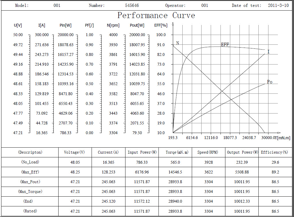

I wanted to ask what the gear ratio should be of my electric vehicle to allow it to have the fastest speed possible, while not blowing up my engine.
The vehicle I'm building has a Servovision 10 kW electric motor. I'll be running it at 48 volts. Further details of the motor are at servovision.
Clear from the table is the fact that the engine would deliver 3500 to 4000 RPM.
The diameter of my wheels is 24 cm (it's a kart). The drive shaft is 4 cm in diameter.
Is there any formula to calculate the optimal gear ratio ? And am I missing one or more variables to calculate this ? If so, what ?
Also, does resistance increase if the terrain is sloped (as I assume), and if so, is this calculated in in the formula ?

I think I found the answer:
the data needed are the nominal and stall torque (when the vehicle is being driven, so not taken when not under load). The ratio between these is probably also the ratio the engine can take (as the engine will about get it a same amount of times harder then the ratio used).
For simple electric DC motors, that ratio is about 1:5 (see http://www.me.umn.edu/courses/me2011/arduino/technotes/dcmotors/motor-tutorial/ ), and it is also about the same as what most people use in their karts (see http://www.diygokarts.com/vb/showthread.php?t=25255 )
For more powerful electric engines like mine (10 kW), the ratio is probably much higher. There's no data on it (since I have not data when being driven -under load-), but when spinning without load, the nominal vs stall torque is about 1:51 (29000/565, see http://www.servovision.com/hub motor/Motor 10 KW/6-26-2013 2-45-09 PM.jpg ).
As for the torque the engine provides: that's about 14,45 Nm @ 3618 rpm

Are you trying to figure out how hard you can push that motor?
That is more of a black art. Basically though you are limited by heat buildup and the laws of thermodynamics, and validated through testing.
http://www.servovision.com/hub motor/Motor 10 KW/BLDC Motor 48VCdata.pdf
it says the rated power is 6.5kw @ 3500 rpm, which is 17nm. and 150 amps (48v). It should be able to do that all day.
torque is related to current, so that little motor makes ~ 0.113 nm per amp, regardless of the rpm (for the most part). No load it makes ~82 rpm/volt. Amps = heat.
You can see that efficiency drops off a cliff at very low load, but from 5nm up it stays above 80% (so don't drive it at low load).
There is no picture of the motor proper, so I don't know if it is internally cooled with a fan, or if you use an external radiator, but an internal fan is rpm sensitive, so don't expect to run 150 amps continuous below 3500 rpm.
You can usually throw more volts at a motor (>48v) and get it to make the same torque at a higher rpm (thus more power). The time limitations are determined by the current (heat) and cooling capacitiy.

Discussion Starter #10 (Edited)
Yup. That's exactly what I like to do.
My first idea was that there was going to be some formula to calculate this out. I think that the nominal and stall torque would probably be an indicator to work out the gear ratio's, and I still think that's the case. I even think that the nominal and stall torque ratio difference of electric engines that are just running free could be used to figure out the gear ratio of the completed vehicle, even if it is being driven. This, because the ratio's between those 2 ratio's (non-driven and driven ratio of nominal and stall torques) would probably remain the same. The only variables that would need to be integrated in a formula to figure it out could be
