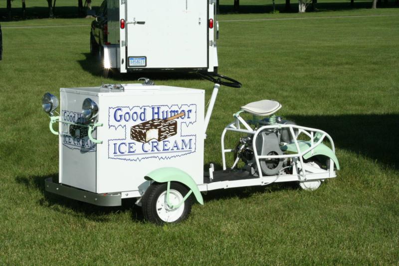

Re: The Inhaler Project's "Ice Cream Truck"
Thanks! :) It'll be a simple swingarm. As it is, there is about an inch of clearance on either side of the tires, with about that much between them. We could make the side of the swingarm from 1/2" plate, with a beefy fabricated crossmember from the pivot to the front of the tires. Then, simple leaf springs on the frame rails, truck style. That's the simple way -
This sprung to mind!
:D
