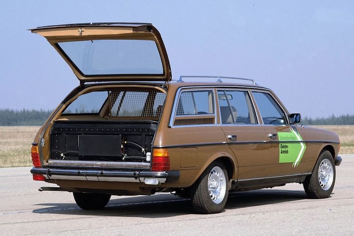

I just purchased a 1984 380SL that has some engine/suspension issues which I want to convert to an EV.
SDU in the back axle and some batteries under the lid wouldn't be too much of a project
Another slightly related side note is that MB made some experimental 190E EVs in the early 90s. Reliable but dull and uninspiring I'd imagine.
