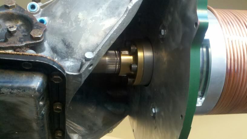

I just bought a second hand TCI built circle track glide for $250. I plan to couple it to an AC50. It uses a coupler and no flex plate or t/c. I will keep you updated as to how it works.

Sorry for the late reply. I had forgotten this thread....
Adapter kit and coupler
AC50 + Glide
in the car
External pump
To date I have not driven it but the 150PSI pump puts it in low gear easily. It is turned on by my foot on the brake pedal. I am not using a pressure switch.
It is a TCI full manual oval-track glide. I had to replace the speedo gears and "bullet" as they were removed for racing.
BTW: the adapter uses the GM Crate engine (later small block) crankshaft flange pattern. The coupler can be bought early or late patterns to suit your adapter. ALSO: I had to play with (shorten) the input shaft and coupler length to get my 1/16" end play to assure the front pump was not end loaded and fail.

UPDATE:
A manual shift/direct drive powerglide works in an EV really well! I have gotten about 100 miles on mine at this writing.
It weighs 75 lbs.- my T-5 manual weighed 88 Lbs. (plus clutch/flywheel/linkage)
Things I have discovered:
1-They are easy to work with and on.
2-They can not be "idled" when a direct drive coupler is used.
3-Mine ran 170 deg. F. after an hour driving in 109 Deg. F. temps.
4-It works with Regen braking just fine. The clutch/band stays locked all the way down to zero shaft speed.(then a 2-3 second delay until it drops pressure and goes to neutral.)
5-I used a 140 PSI pump, but you might get by with 80 Lbs or so.
6- For EV use, do NOT use Kevlar in the frictions. You can really use the stock-factory parts OR use the RED or BLUE racing friction parts. Kevlar only accelerates wear because it is aggressive.
7-Do NOT use an aluminum front drum, the low band wears them fast.
8-DO use a steel front hub.
9-DO use the rear clutch case savers (made for trans brake duty). It is just good sense and stops case wear for the reverse clutches.
10-DO remove reverse clutches. Run 2 on a light car(2500# or less), run 3 on all others. It reduces friction,wear, heat while in forward gears.
11-There are several small holes to drill out to increase oil flow to critical areas. Get a book.
12-No need to change to a turbo type input shaft for strength.
13-you can eliminate the "kick down" lever and rod, as you dont want a "passing gear drop down when driving an EV."
14-Always loop the cooler circuit. It lubricates a less critical portion of the transmission that the main pressure gallery omits. Only eliminate the loop if you are changing the valve body or really know what you are doing.
15-There is not a single port to supply to both forward and reverse from an external pump. I am plumbed into the low band apply servo cover. I do not have pressure in reverse and must apply throttle a little until it clunks into gear...annoying for sure.
I need to rebuild my Glide this winter and will search for the correct place to pressurise the trans to have both forward and reverse gearing.
Those "air cooled" powerglides may be a better choice for an EV, especially if you are direct coupled. The torque converter makes 80% of the transmission heat. The low gear planetary makes most of the rest.
I like the 1.85 gearing for my purposes. It is lighter duty than the 1.72 version, but my usage is way with in the GM normal standards.
All the 4 and 6 cylinder applications and some of the 283 cars are 1.85 gearing. All the 327 and up V-8 applications are 1.72 gearing.
They can be told externally by the output shaft splines and the shaft diameter is smaller in the 1.85 versions...but they both use the same output yoke....go figure...
In my area, on Craigslist, I routinely find powerglides for $150-$400 or so, depending on the condition or if it was recently rebuilt.
More when I go into the trans....Miz
