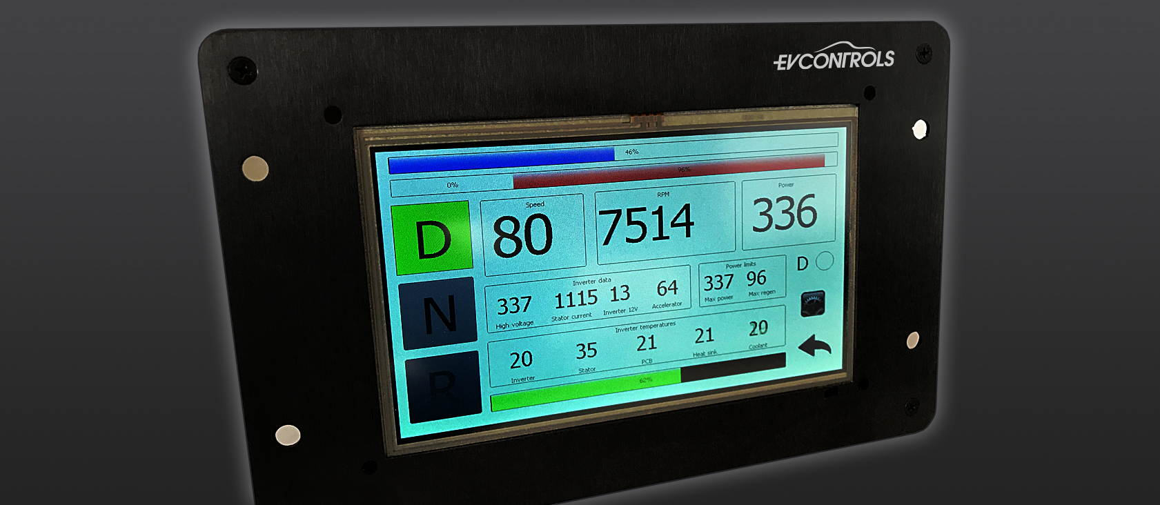

Controller: EV Controls T-1C, pretty close to turn-key, i'd buy it from EV west specifically so i can lean on them for tech support and general info. This controller's already been used in a few tesla motor/chevy volt battery builds

Controller: The drive unit for the tesla comes with a controller of sorts. You might as well use it rather than spend $3500 on another controller. I think Damien (EVBMW.com) has a kit you can build yourself that can control Tesla drivetrains.

this 818 uses the T-1C controller, it's their shop car
