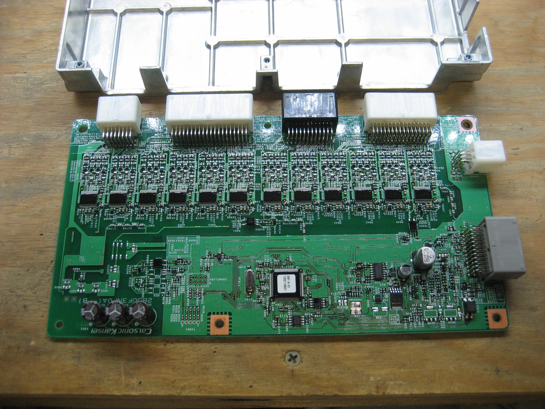

Hello,
I have a 2013 Nissan Leaf battery pack, which I am using to reverse engineer the serial protocol between the microcontroller and the balancing ICs, so I can reconfigure the pack for use in my Solectria E10, and still use the BMS.
I recently purchased a 2013 BMS on eBay and it was different than the one that came with my battery pack, so I suspect it was actually an earlier version...
The BMS that came with my battery pack uses D15120 balancing ICs.
The BMS that I got on eBay uses D15110 balancing ICs.
I have sniffed the serial protocol, and it is different between the two types of Balancing ICs.
If anyone has the Nissan Leaf BMS left over from a conversion, I would be interested in buying it if it matches the one in my battery pack.
The BMS I am looking for has:
Plastic backer, not metal.
One gray and black connector, not all white connectors:
http://www.wolftronix.com/E10_LithiumUpgrade/images/IMG_5574.jpg
Has the D15120 balancing ICs, not the D15110 balancing ICs.

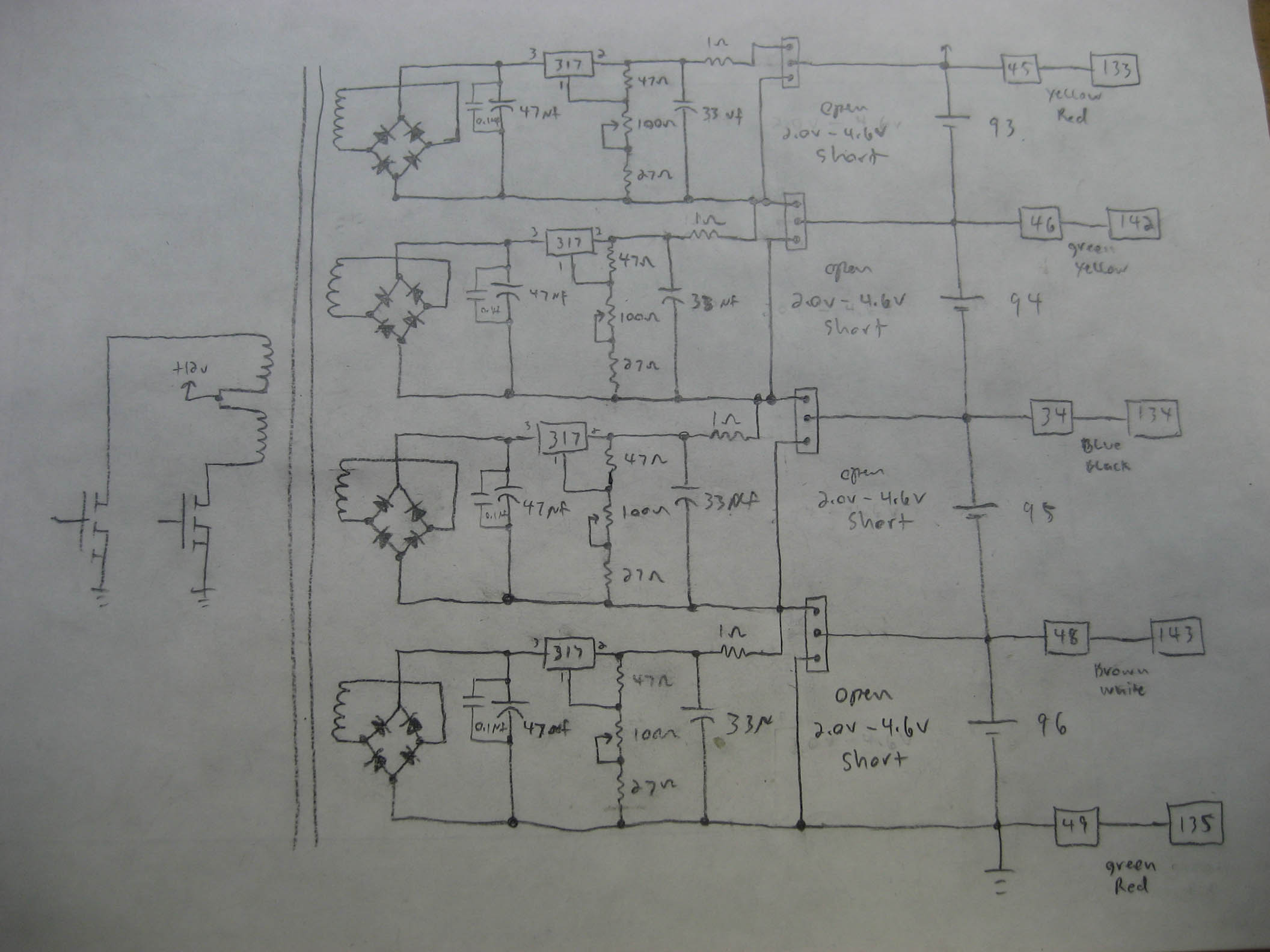

Yeah the shunt resistors are only 430 ohms so under 10mA.
Actually the balancer chips when active draw 5mA (when the shunt is off), and 0mA (need a better meter), when not sampling the cells.
The current was measured using a 1ohm resistor on my cell simulator:
I am uploading a youtube video with the findings right now... but it still has about 4 hours left to upload (I have a slow internet connection). ;P

thanks for the work.
Also good diagram of the cell simulator, will be usefull to reverse engineer any bms system. :)
No problem... :)
For those that want to recreate it:
On the primary of the transformer, the MOSFETs are turned on out of phase with each other at around 50kHz, (slightly less than 50% duty cycle to prevent cross conduction).
And I would multiply all the resistors by 1000, (except the 1 ohm current sense resistor).
The resistor values are scaled for the 100 ohm 20 turn pots I all ready had... and the regulators get a bit warm to the touch.
Also, there is a 0.1uF ceramic cap across each 33uF electrolytic cap.
And cap values where chosen from the stock I all ready had... ;)
It is literally built out of spare parts, here is a time lapse video of its construction:
http://youtu.be/TVPOZZTasEg

Over the last few days I mapped out all 100 pins of the Nissan Leaf BMS microcontroller.
And I finished a board layout to adapt a dsPIC33EV256GM106 microcontroller to the PD70F3236 microcontroller footprint.
This will let me replace the existing microcontroller, and then I will have full control over the BMS hardware. :)
Enjoy:
