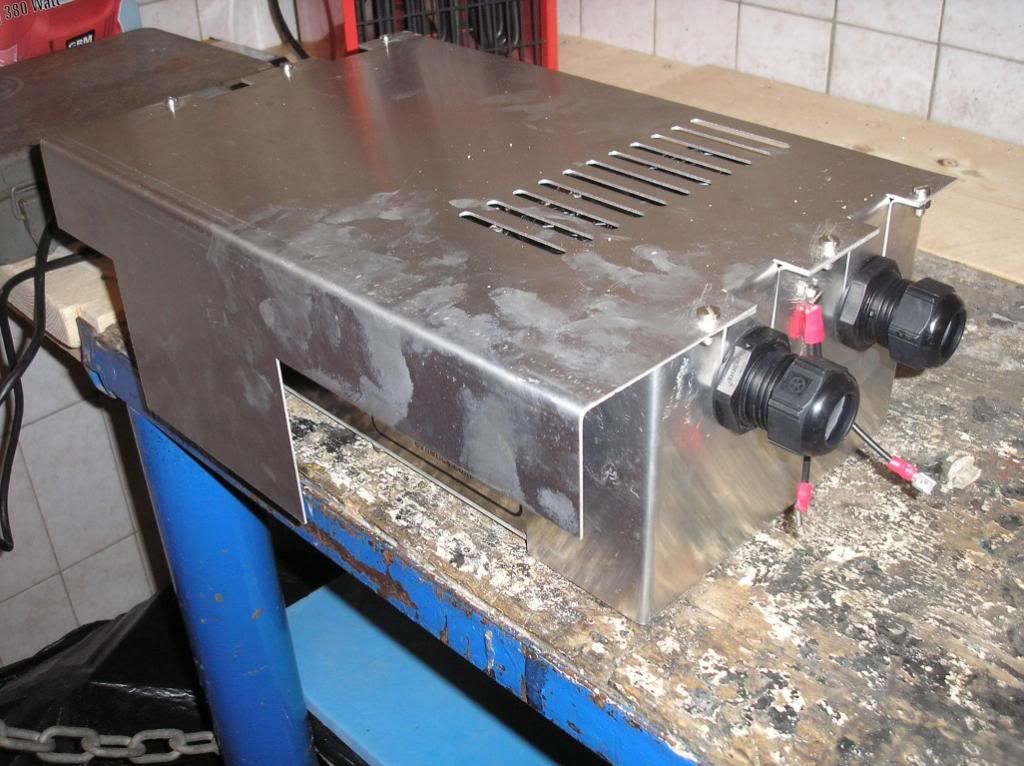

Made some progress. Received almost all the parts now, except for the batteries.
The EMC enclosure for the Soliton Jr is pretty much ready to be installed now. Ended up using cable glands since the pass through rubbers didn't really fit. So this is what all Soliton's should look like now in Europe:
Too bad it completely covers up that good looking controller but well, it's the only way to pass that road test. ;)

Also I don't believe complaining to the officials about the EMC rules is going to help, it is such a small market here. Especially here in the Netherlands, they won't care if like 0,1% of all people will complain about it. The RDW is very strict also, last few years they have made everything for the DIY's so much harder, not just the EMC rules. Just have to accept it or try to work around it somehow. ;)
