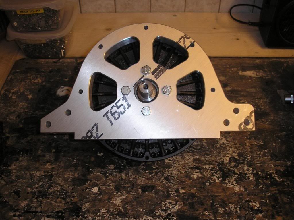

Finally some progress again. The motor plate has been made and as I hoped it fits perfectly on the rear swing arm. Also no problem at all with the suspension.
I also tried with the chain and it has enough clearance with the frame to be placed in a straight line.
Next step are the mounting blocks for the motor plate which will be welded on both sides of the swing arm. The adaptor for the front sprocket and custom rear sprocket is also being made. Will probably get both next week already.
I've also started playing around with Sketchup and I really love this program now. So easy to work with and it really helps when actually making the real things. ;)
Here's the complete motor mount, can see the mounting blocks here. Also tried to make the motor look close to the real one since I was a bit bored waiting for parts. :p

The mounting blocks for the motor plate were made and TIG welded on the rear swing arm.
The adapter for the front sprocket was also made and fits nicely. It also has 2 small channels for the RPM sensor. Still have to make a small mounting plate for that.
Here you can see how much I was able to take off the original chain. So nice that I could fit the motor there. It's a lot better also since chain tension will always be the same. If it were mounted in the frame it would constantly change because of the suspension.
And here I shortened it and tensioned it. Pretty nice to finally have this attached, first step of the build-up completed. :)
The sprockets aren't perfectly aligned though, so I will still need to get some sort of adapter made for the rear sprocket as I can't move the front sprocket more outside because of the frame that's in the way. :rolleyes:
