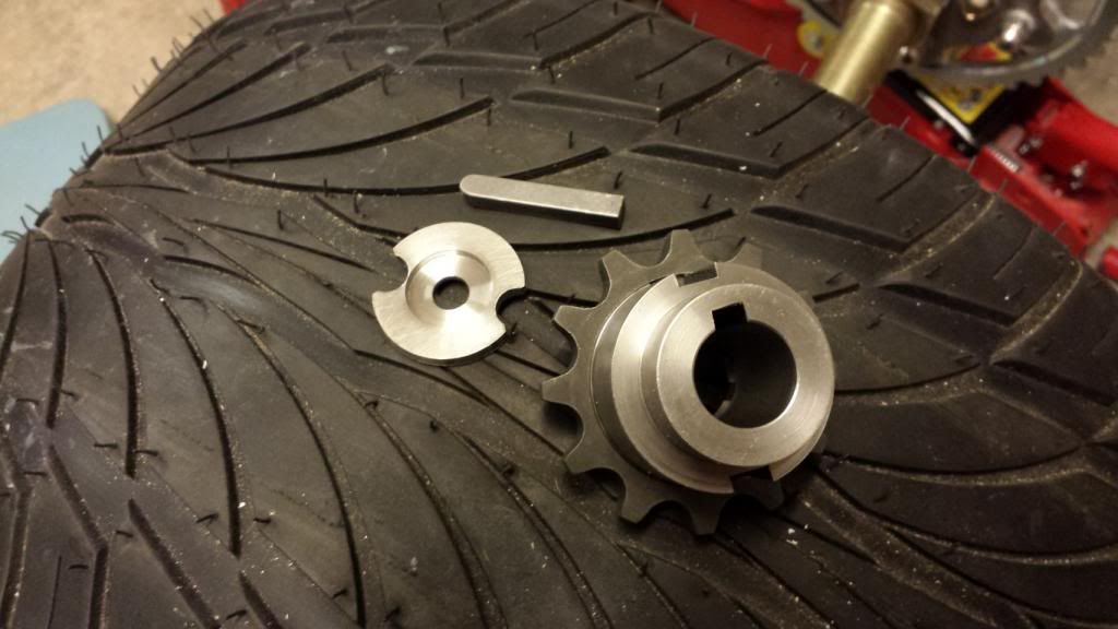

I had to replace the coupler for the front sprocket as the set screw to hold the coupler in place was in the same line as the cutouts for the RPM sensor. So ofcourse this would never work well (it wasn't my idea to have set screws :rolleyes:). I had a lot of trouble taking this coupler off though and found out that it had damaged the motor's axle a bit. So I already had a bit of repair work to do and had another coupler made just the way I wanted it from the beginning. It turned out quite well but still not perfect. Especially since I needed a keyslot in the coupler and it's been very hard to find someone who could do this. Fortunately I did find someone and I'm pretty much having everything made there now since they do a good job.
Anyway, here's the new coupler with the sprocket on it.
And attached to the motor's axle.

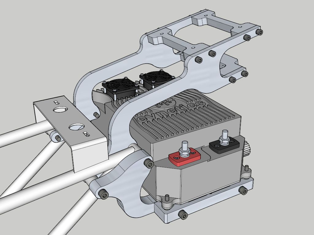

The mounts for the controller are finally made. While waiting for them I got a bit bored so I tried to make a 3d model of the Soliton Jr. Think it turned out pretty well, just can't get it to shine like the real one. ;)
But anyway, the mounts for this controller. My thought was that this cool looking controller just needed cool looking mounts. So I went all out drawing these and had them made. Still had a 25mm aluminium plate here so they used that one. It's definately strong enough. :D They also made a small mounting plate for the RPM sensor since the one I made myself didn't really look so good.
Mounts on the frame. Had to use some rings on the rear mounting points to get the mounts straight since they were more to the inside of the frame than the other 2.
And here with the Soliton Jr placed on there. Still have to put that enclosure around it but for now I rather see the controller itself. :)

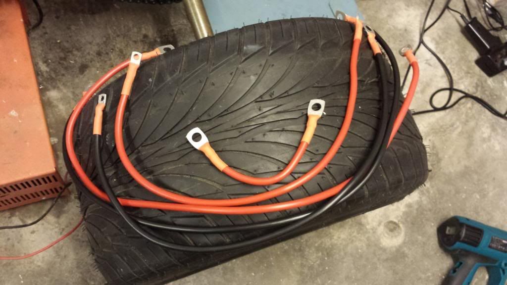

The first test drive has been a success! :) Now I really know what the EV grin feels like. :D
I used some bigger test cables for this to see if I could push some more amps through them.
Also used EV display so I could see how many amps I'd be drawing and to see voltage.
I placed 2 12V starter batteries in the frame, figured that would be enough for a first test ride.
Also mounted my other new toy. :)
And then it was ready to go outside for the first time. :D
Though I expected just a bit more power from these starter batteries I still had a lot of fun! It was drawing 50-60A sometimes, didn't really get much higher. The Soliton Jr was set to 25V max to motor and 120A battery/motor. The voltage sag was pretty bad too, ran out of power rather quickly. But yeah, starter batteries aren't made for this. The first few runs were great though and still at the end with pretty much empty batteries it managed to crawl uphill. To me that really shows how strong it already is, even at less than 1kW. I just can't wait now to test with the lithium pack. Just still have to get the battery boxes done and figure out how to secure them properly on the frame.
Anyway here's the video that was made. :)

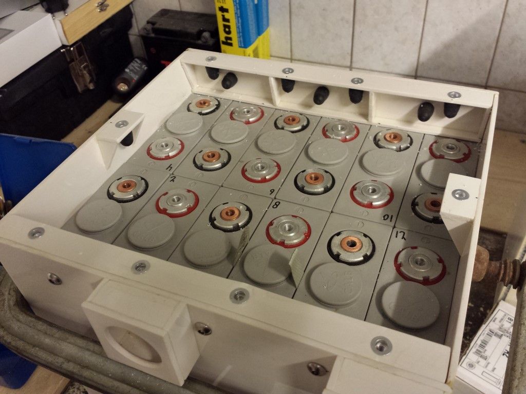

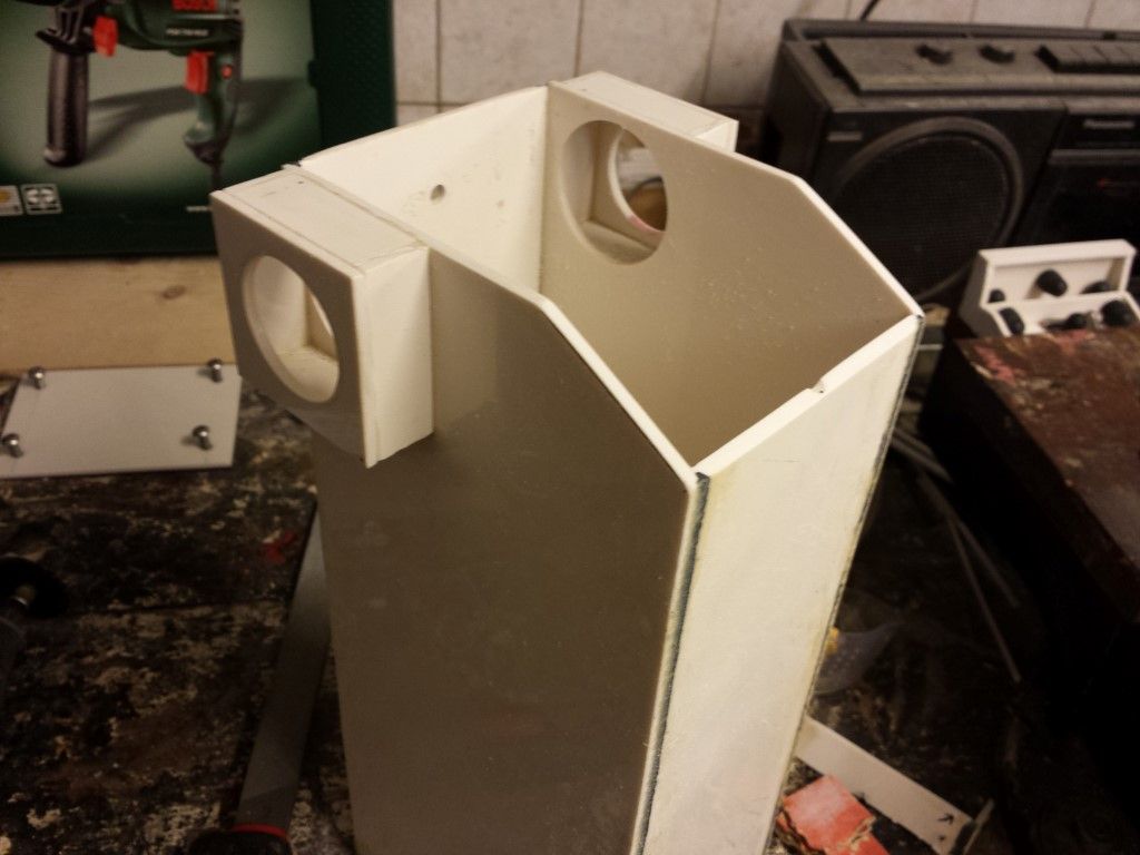

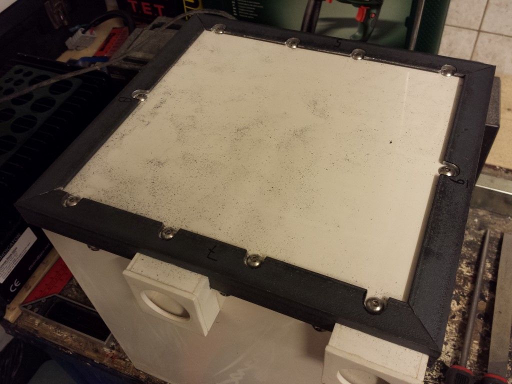

Today I modified the smallest battery box a bit since this one didn't fit very well below the carbon front fender (which comes on top of the red one ;)). First I just cut a small part off to try.
But this just wasn't enough, so I had to cut off some more. Because of this I had to move the mounting points for the cover to the outside and there's also no clamp for the batteries on this side. But this isn't really a problem for this box since this will be placed almost straight up, the one clamp on the other side should be enough.
Also made a new cover since this had to be a bit longer. The bending went pretty well.
After that I made the holes in it, attached it and evened it out nicely. Then I tried fitting it again. Fits reasonably good now. Still not perfect but I can't cut anything off it anymore. If it won't work out like this I'll unfortunately have to modify the carbon fender a bit. But I think it'll be fine.
And a new layer of EPDM rubber inbetween to keep any water out.
Also rounded off the corners on all battery boxes where the steel corner profiles will come up against since the corner profiles are a bit rounded on the inside as well. Tomorrow I can start making these corner profiles to size.

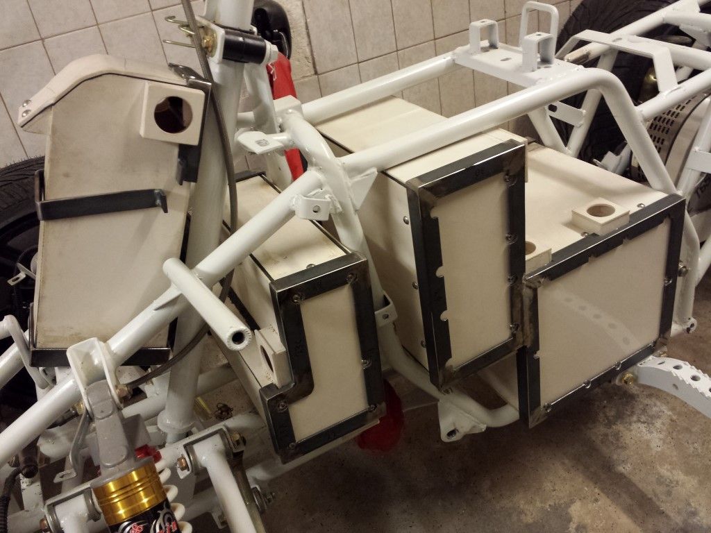

The corner profiles for the rear of the battery boxes are done. Now I still have to work on the ones for the front/cover but that'll take some more effort since I have to cut a few parts out for the cable glands and bolts.

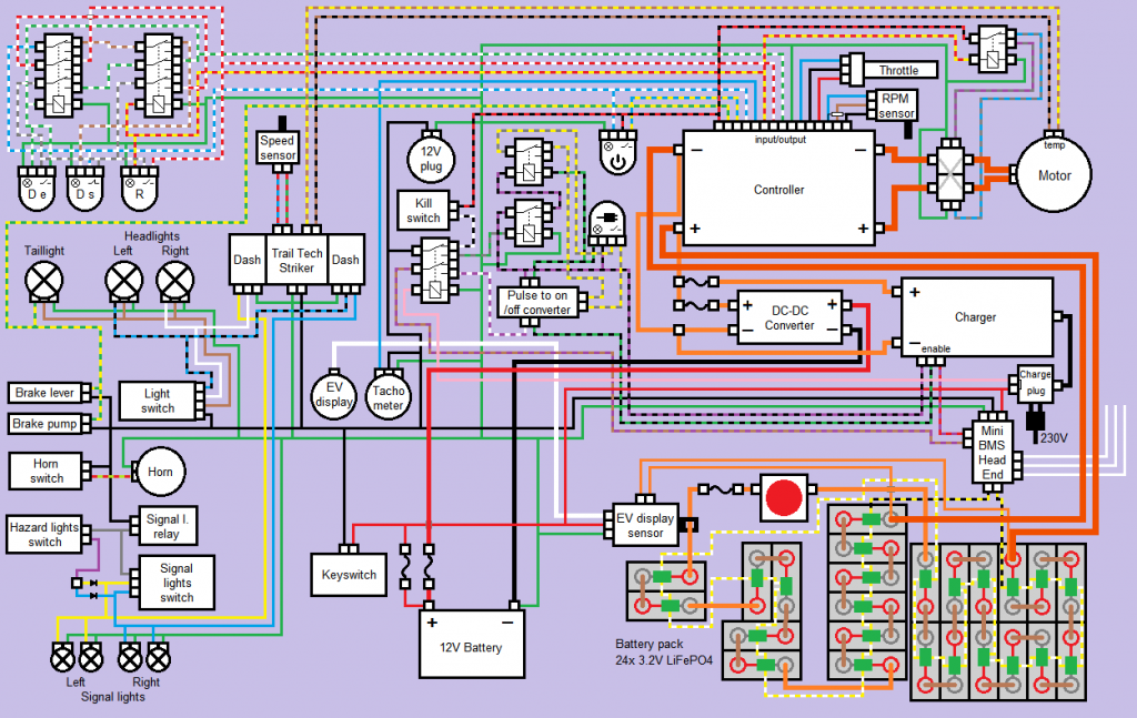

Past few days I've been busy drawing the whole wiring diagram. I'm pretty sure everything will actually be connected like this now. Only those 3 wires of the Battery Management System I'm not really sure about how to connect them yet. I can't use the Soliton input for this since I'm already using all 3 inputs (start input, reverse input and throttle limit input for switching between 2 drive modes). But the manual of MiniBMS is pretty clear so I can probably just use the diagram for hall sensors and it should work fine.
Also made 2 extra circuits in it with a few buttons and relays. The one on the top left is for switching between low power (Drive Eco), high power (Drive Sport) and Reverse. And the one in the middle is for starting and stopping the charge process when the charge plug is connected. I might still get an actuator for this so the charge plug will get locked with this circuit while charging.
If you see any errors or have any suggestions on how to wire certain things in a better way, please do let me know. ;)

For the rest I've still been busy with the corner profiles on the side of the covers. Have to make quite a lot of cutouts in them for the cable glands and bolts. So this'll still take me a while. But for this battery box they're all done, still 3 to go.
4

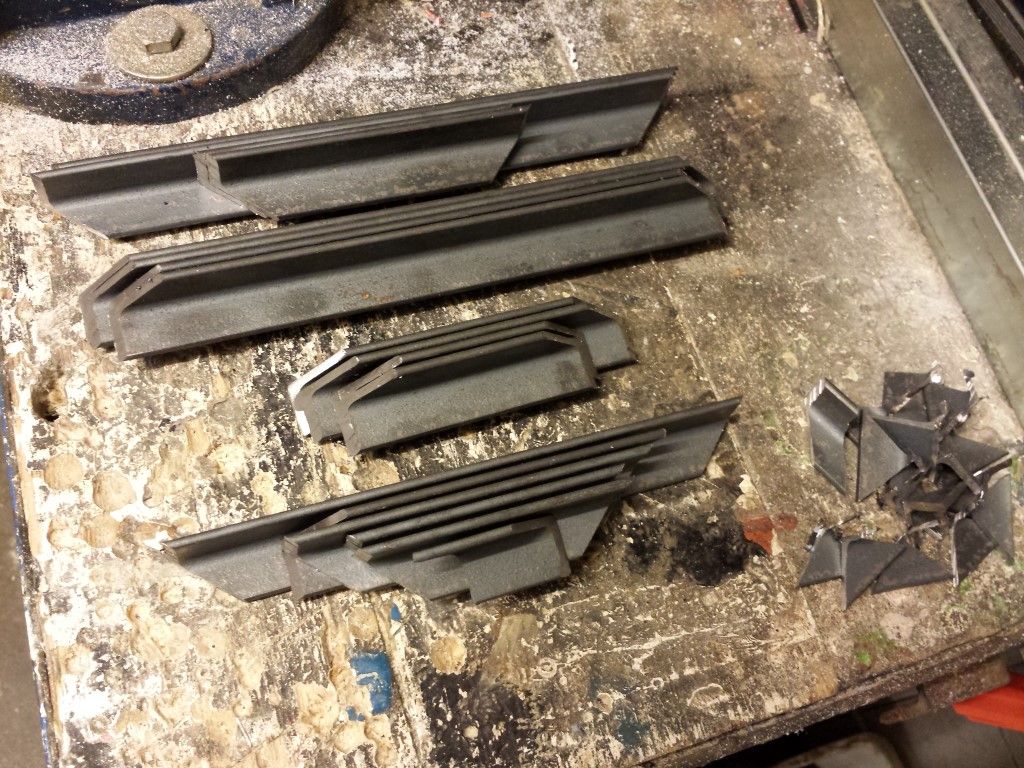

The corner profiles which are going to be holding the battery boxes in place are finally all done.
For the small box I had to do something different, this will be 2 seperate parts which can be attached to eachother and also to the frame. But you'll see this when it's welded, it's hard to explain.
Here's everything together. It all fits perfectly and is ready to get welded now. I'll only get these corner profiles welded first, it's a bit easier to see where the mounting points will have to come once everything's stuck together.
Hopefully this can be done coming week but after that it'll take some time again to make all the mounting points.
The corner profiles are all welded now. Done very nicely again by the same welder that welded the blocks onto the rear swingarm back then. He also grinded off the welds on the outside already. I still had to grind some off myself on the inside to make everything fit well.
I just wonder how it'll fit once everything has been sprayed but I guess we'll just have to wait and see. There's also no clearance at all anymore now between the frame and the 2 big battery boxes so it's important now that the mounting points will get welded in exactly the right spots. But I'll still have to make them all, will keep me busy for a while.

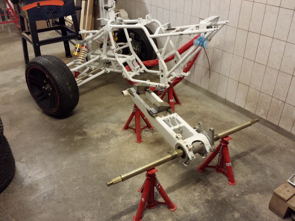

Much has happened again this week. I completely dismantled the quad bike so that all parts of the frame can be sprayed soon. Was pretty fun since I've literally had each and every part of the quad bike in my hands, I know exactly how it all fits together now. I've also come across certain things that I'll be replacing right away with better alternatives, especially the bearings and the bushings in the front swingarms and rear swingarm.
I was able to remove the whole brake system without even having to disconnect a single brake line.
And this is what the quad bike looks like right now, only parts everywhere.
I already removed the bushings in all of the swingarms. These are all still new bushings but they don't really look like that. These Chinese bushings also don't really work like rubber bushings are supposed to work, they're actually hinging in the swingarm itself instead of in the rubber so it's steel on steel. This will wear out very quickly, especially since there was no grease at all anywhere. The plan is to place POM bushings in here, works much better and lasts much longer too.

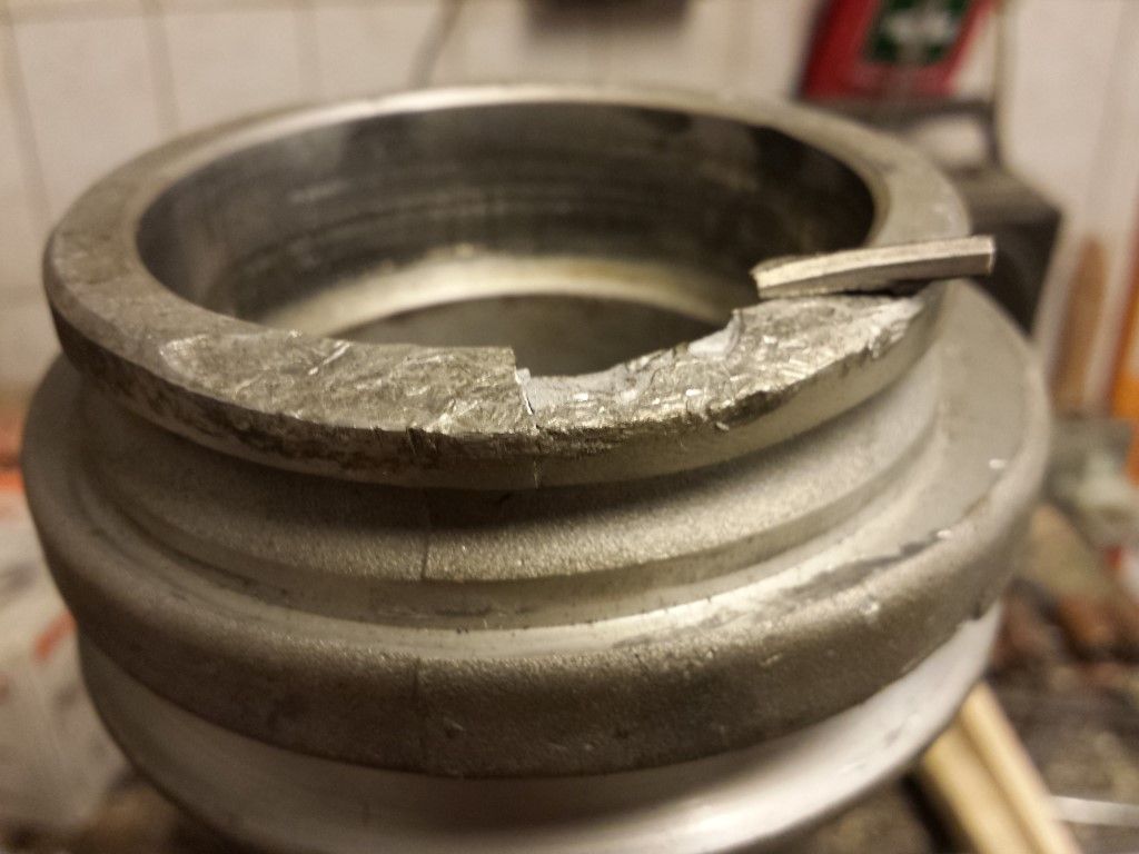

The less good news first. I wanted to remove the bearings and axle from the bearing house so I can soon place much better bearings of the brand SKF in here instead of the Chinese bearings. This just didn't go so well on one side, a piece of the bearing house broke off and there's a small crack as well. So I can't use this one anymore.
But I did get everything out so at least I know how everything fits together now.
Here's one reason already why I don't want to use these Chinese bearings. Just look at the difference between the 2 bearings, the one on the left has no grease at all in there while these are still new closed bearings. But they're bad quality anyway, these bearings break very quickly. Especially that one without any grease.
Meanwhile I already got a new bearing house. There were also bearings in this already but everything went well removing them this time.

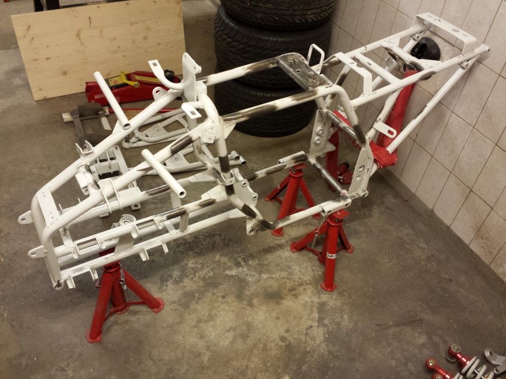

This weekend I took the time to take on the frame. There were still some small parts of the old mounting points on there which I had already cut off last year. You can't see anything of them anymore now. I also removed a few other mounting points which aren't needed anymore and took off the paint in the spots where the new mounting points will be. So I really have everything ready now to get it welded, just have to wait a bit till the welder has some time.
Also made the corner profiles already which will be mounted across the frame. These will be carrying and dividing the weight of the battery boxes. It was just tricky to get it all to fit, I really don't have a millimeter to spare anywhere. So I just grinded them out a bit so the frame's tubes fit right in.
But now I can't really do all that much anymore till everything is welded. So I'll have to wait once again.
