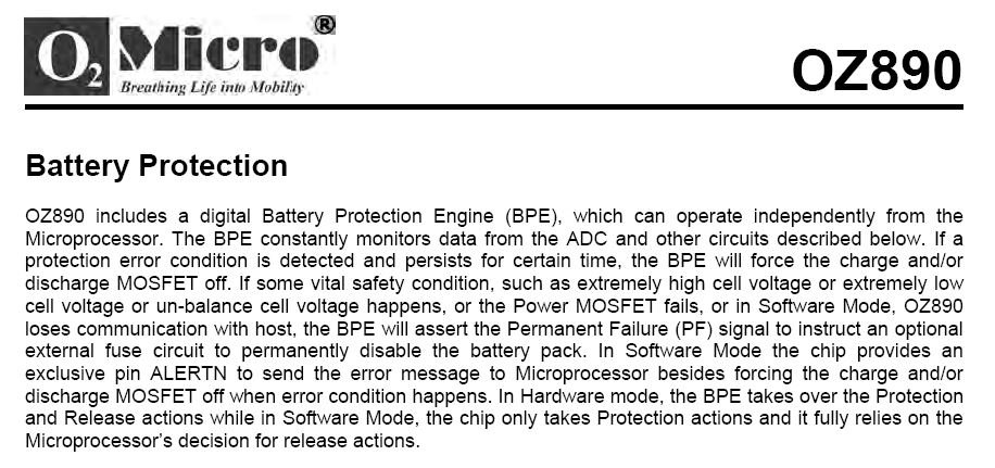

kennybobby;1011793 The OZ8940 chip drives the FETs and that is what needs to be understood how to keep him happy. i'll post that schematic after i draw it up. It sure would help to have a datasheet for that thang.[/QUOTE said:
FEATURES
• High power BMU
• Highly integrated battery pack monitor and protection
- Li-Ion and Li-Polymer (Co, Mn and FeP chemistries), NiMH and Fuel cells - 6-12 cells standalone
- 6-12 voltage channels, 2 external temperature channels
- Fully programmable battery protection parameters
- Built-in protection includes: over-voltage, under-voltage, over-current, short circuit, over-temperature, under-temperature, cell unbalance, and permanent failure
• Internal cell balancing
• Low power consumption
GENERAL DESCRIPTION
OZ8940 is a highly integrated IC for battery pack protection and monitoring, used to manage Li-Ion and Li-Polymer packs with 6-12 series cells.
With an integrated multi-channel 12-bit ADC, OZ8940 continuously monitors each cell voltage and pack temperature to provide maximum battery safety. It also provides a Permanent Failure function that will automatically assert a signal to blow an external fuse to open the power line or to signal an alarm to the user.
OZ8940 may be con gured to work in standalone “hardware” mode or with a microcontroller in “software” mode by con guring the EEPROM.

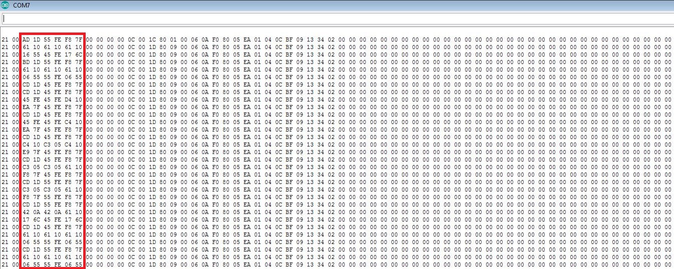

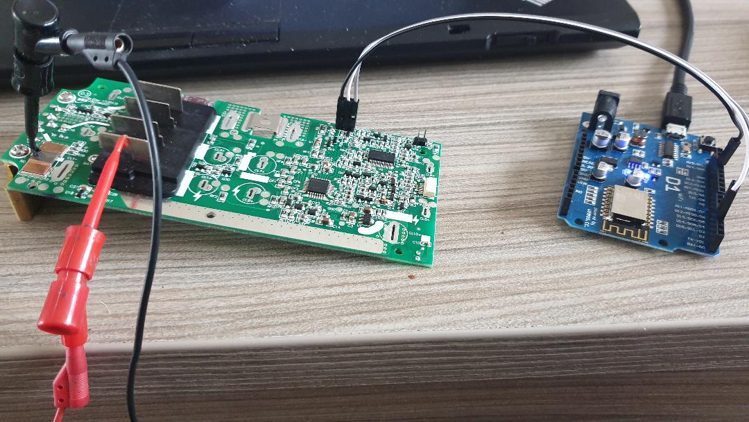

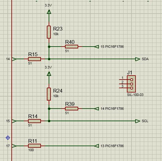

Hello From France,
Here, we have the same problems with the Ryobi Batteries.
The 5Ah BMS seems to lock up without reason. All cells are good.
I'm also creating the schematic of the PCB.
The 2.6 Ah and 5Ah own differents PCB.
On the 2.6 Ah , there are one only Power mosfet, wired to OZ8940.
I wrote twice to O2 micro to ask for the technical datasheet, no answer.
On the 2.6 Ah , the Microchip is a HA1930, no documentation anywhere, but seem to be the 16F1786.
I have not yet understood how is made the dialogue between the charger and the battery.
I don't know if the firmware is locked, anyway, it's very difficult to understand the machine code extracted.
Finally, the simplest will be to rebuild a complete program.
The OZ8940 is configured by the PIC with the I2C protocol. With a scope or I2C spy, it's possible to read the dialog during the startup of the PIC, after the RST.
We find the OZ890 Datasheet on the web, maybe, the I2C registrers are the same.
I confirm it's a big job !
