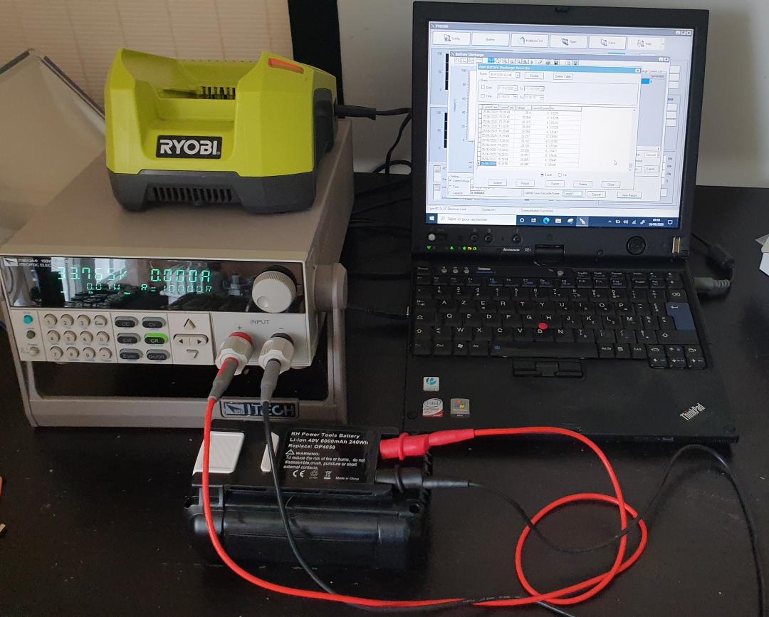

I will try to solder a 2,6 Ah BMS on this 5Ah battery.
Test to follow....
2 Posts
Oric,
Keep us updated on that AliExpress battery.
Do you have a link the the one you purchased?
Can you tell what the cell manufacturer and model are used?
51 Posts
Oric,
The cells marking is THISS 18650HR20R
Probably a 2000 mA, with 2 in parallel, the nominal capacity is 4000mA and not 6000mA as notified on the label.
Two discharge tests on my electronic load gave 3500 mA
The weigth of this battery is 1.2 Kg vs 1.5 Kg for an original 5Ah.
The battery accept to charge on the original charger.
But the capacity indicator is false. The 3 first led rise very quickly. In 1 minute, the 3rd led is flashing.
Unable to post a link on the forum.
But write "Powtree Ryobi 40V LED 6000mAhOP4026A" on google.

The cell balancing capability is very limited with the OZ8940 chip, like .008 Amps of discharge current depending upon the value of the RF1 resistors. It may be that the code just gives up if the voltage difference exceeds some stored limit, another reason for all the "dead" packs out there for sale on ebay.
Good work to get them matched close enough for it to recover. It takes a good DMM that can read down to the mV level generally for messing with cell voltages. 0.1 V is a huge difference in cell world.
