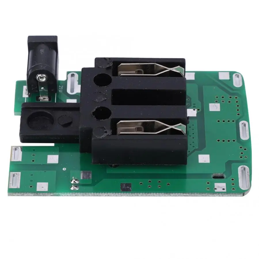

Hello Kenny,
For the female connector, i ordered twice adapter on aliexpress, for 2$ each.
i'm waiting them, to verify or modify to adapt to the battery
