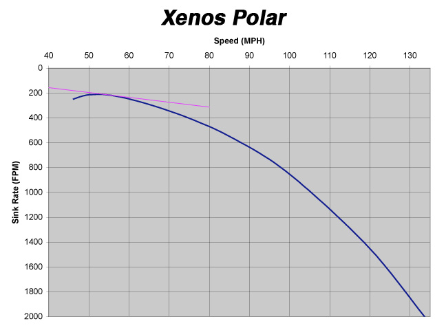

Also motorglider and xenos ftw but they are both hard as hell to find used . whereas you can get a regular sonex/sonerai/pulsar anyday of the week if you look hard enough . a xenos you'll have to build and will start costing corvette money by the time your even lookin at motor options.

Personally speaking as as a glider pilot and an electronic engineer, given your stated goals I'd go for a nice standard 'off the shelf' self launching motorglider if it's the flying you're interested in. Second choice, with a much bigger budget and pretty well purely for the pleasure in the project and for quiet flight I'd go for an electric conversion on an existing self launching motorglider. Sell the ICE to pay for some bits. Seems like an expensive option to me but then I think the regulatory environment is a little different over there. A battery fire would be my main concern, pretty much every other powertrain failure in an SLMG you'll walk away from.

Since your a gliding pilot and engineer i was wondering what your thoughts were on the Xenos by sonex and the Europa Xp with Glider/Long Wings? they both get 40-45+mpg on their best "economy" behavior and both sport engine out landing abilities. They also seemingly stay in theme within your electric self launch motor glider params

-I'd also like to go back to the above underlined text, 95kts-100kts is not best fuel consumption speeds. Its the average continous speed on a trip . By slowing down you get better fuel consumption. Especially if your using electricity. allow me to elaborate with visual aid
http://www.sonexaircraft.com/images/products/xenos/XenosPolar.jpg

A large modern glider with an L/D ratio in the mid 30s only needs ~3kW input (net after losses) to sustain level flight (calculated from l/d, speed and mass) at nearly 100kph. A mere 10kWH of battery now gets you toward 200km range in still air and level flight. I think this may point toward where we'll see electric flight going until energy density improves significantly.
Once again at 27:1 your not doing bad -http://www.pilotfriend.com/experimental/acft2/73.htm
