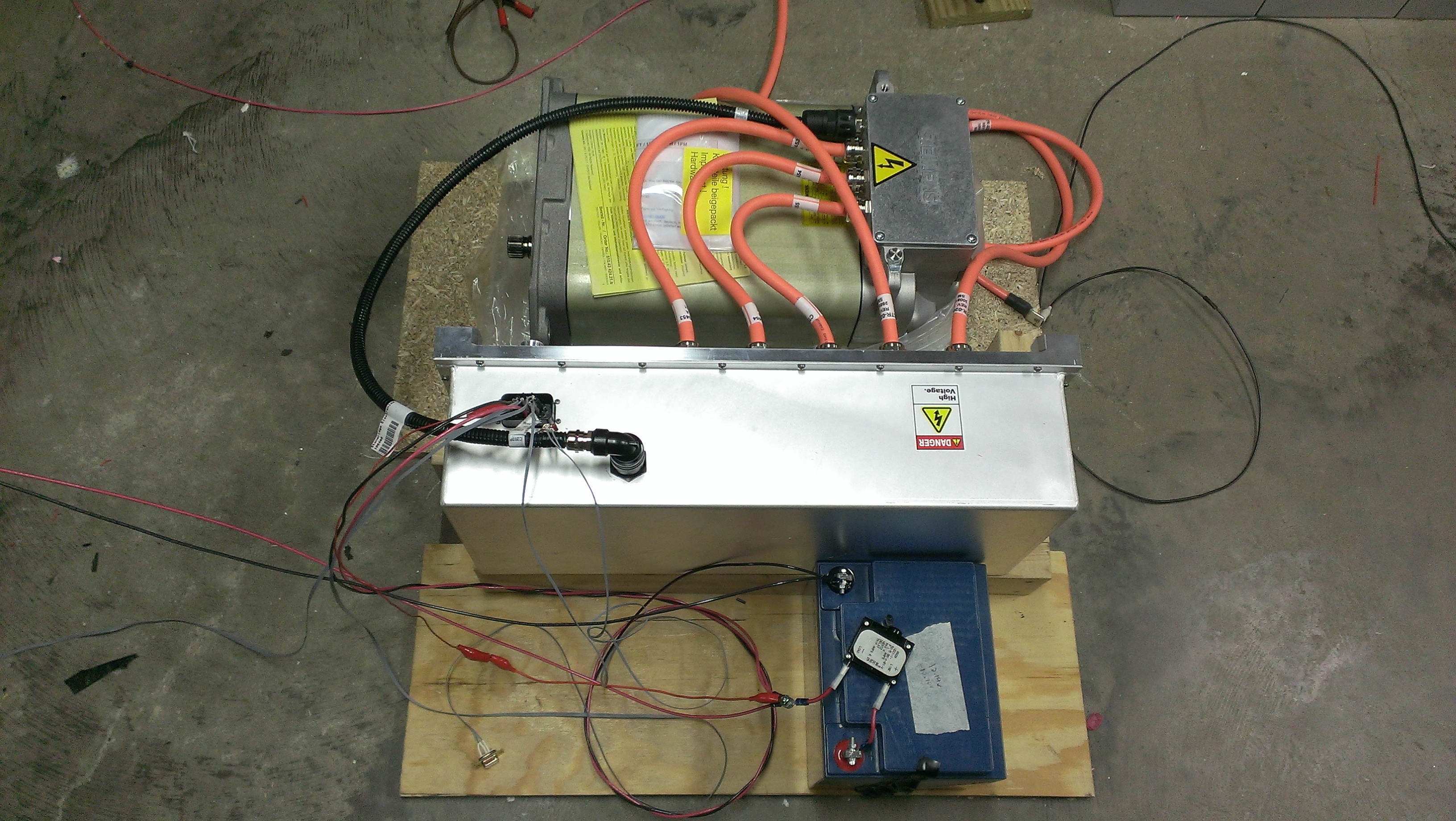

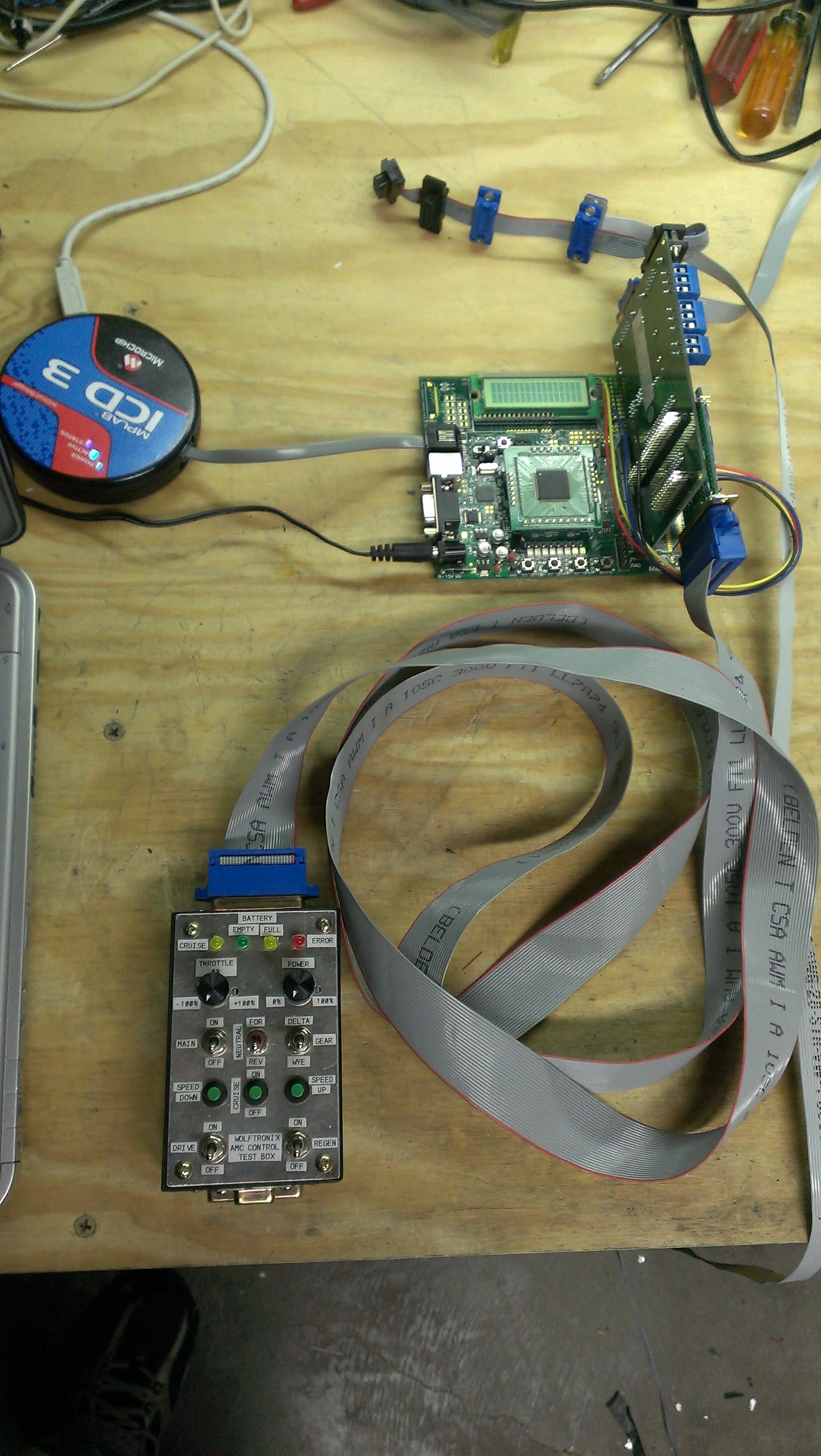

Well I haven't seen the inside of a DMOC 645 but inside AZDs latest rendition of controller the 845 they were using SKiM 606GD066HD modules rated at 440 amps at 70C or if you can cool the junction down to 25C then your rated to 550 amps. Not bad for a footprint thats only 10cm x 15cm.
Attached pics of these controllers. I have more than one. Same controllers as on the 645 (TIs 28F335 and 470 Cortex M3 device).
Cool. :cool:
Just to clarify, the Semikron Skim606GD066HD is rated at 641A at 25C and 512A at 70C. The nominal rating of 600A is good up to about 105F (42C).
I have the 606 in the Scott Drive 200 that is going into the 36 IH with the BLDC, PMAC, or whatever you want to call it.
While it is capable of over 250kva peak, with battery sag, some heat, and motor losses I figure roughly 180kw output.

You spoke poorly of the DMOC which is also a 400A controller. Any particular complaints against it, or just that it is your competition?
I have seen/researched a few control/driver boards from across the models, and I don't like the design personally. Picked out a few component p/n's which seemed borderline spec'd, 2 layer boards, some crucial traces seemed too long & too many via's with no stitching caps, etc. I'm very picky though.
Also, at the time it wasn't working yet people were still charging a premium for them... but I now see some people have got it spinning the Siemens motor which is cool, and now justifies the price.
So no, not competition, all I meant was I wouldn't buy it over some of the better known brands.
Sounds like you are going into the controller business. :)
Nope, just writing a thesis on induction motor control.
If I was going into business, I wouldnt of given away my schematic and code to so many people.
