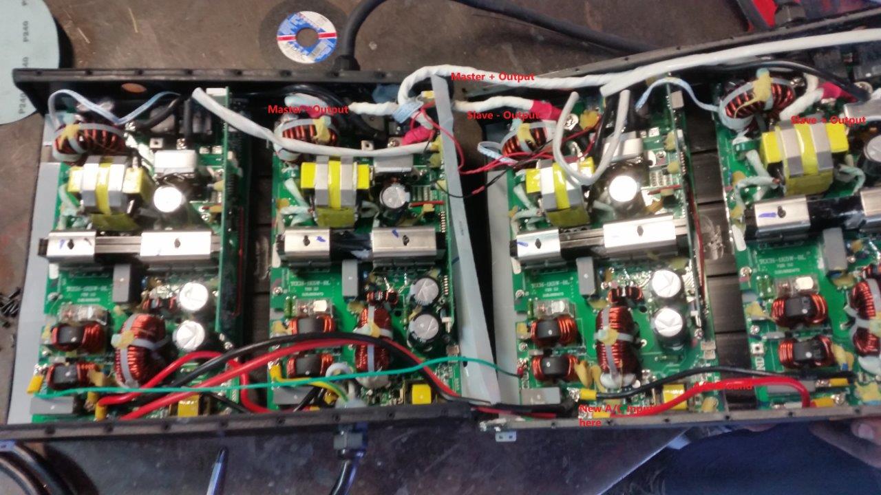

I'm in the middle of upgrading the AGM batteries on my boat to LiFePO4. The bank is 32 x 180Ah CALB cells in a 24V arrangement (4P8S)...but that's less important. I'm using an Emus BMS, and ordered the Elcon to support CAN charging.
Through some miscommunication with Elcon (that I'll take the blame for initially, though communication there has not always been 100%), what I wanted was two 3000W chargers in parallel. What I got was one massive 6000W charger 220V in, 24V out, with CAN. Other mistakes were made (like Elcon omitting the CAN dongle and any manuals from the original shipment, leading to confusion on where to connect the CAN bus), but the big delay is splitting the charger.
Several reasons for the split. The primary is that the double charger doesn't fit anywhere in the boat; it could not be installed safely in that configuration. Secondarily, I don't have any 220V circuits on the boat that can handle a 6000W load, so the source power needed to be split up.
From discussions with Elcon, I concluded the best thing to do was split the Master and Slave sides, get back plates made to mount these where I'd originally planned, and rewire them. Them being in the US and me being near Brisbane and already paying for marina space with my boat disabled in the middle of this project was a factor in not shipping it back to them, which could have taken a couple of weeks (waiting in a marina at rates for a 53-foot boat...).
As configured, the two chargers had one massive welding cable each for the positive and negative outputs. The cables were split at the base, with one half of each bundle being sent to a contact on each side of the charger, paralleling them together. (see picture)
There also was an AC input on the master that was wired to the slave.
My thinking is that taking each point where the output bundles go and making them outputs for each half would be the best way. So the + out and the - out from Master and slave are disconnected from the original cables, and new output cables are run from each source. Then, I could connect them in parallel outside the two boxes and have the same effect.
The slave also required a new A/C input (and to have the leads from the Master removed) and the CAN wire needed to be cut, extended, and reconnected.
Heres's the problem. I did all that. But when I turn the chargers on, charging kicks off...then the chargers start drawing massive load OUT of the batteries and the AC power connection to the Slave gets so hot it almost melts the wires.
Also of interest, when we completely disconnected the Slave, the Master would only put out about 1/3 of the current the BMS was requesting while making an odd high pitched whine.
Elcon suggested I might "have the slave wired backward" without telling me exactly what that might mean or providing any guidance on how to have these wired properly in the first place. That, and some finger wagging about how I should have shipped the 50Kg charger back to the US so they could rewire it... With instructions could do this in an hour or two instead of spending $$$ and weeks shipping it around the world and back, but I clearly screwed something up.
Anyone have any insights on how I screwed this up? And how I can fix it?

The picture is not clear enough to read the printing on the boards or trace the wiring, but it looks like you have 4 1.5kW chargers ganged together. So i'm thinking that there would be one master and 3 slave units to make up the 6kW unit. And if you want to split them, then one of the slaves must be configured into another master.
They look like the older boards for which we have schematics, http://www.diyelectriccar.com/forums/showthread.php?t=89470,
But our resident expert on these chargers is "Coulomb" from Brisbane, and he has more experience with those big monster chargers. Which marina are you located?
If you wired up the slave outputs backwards, i.e. with reversed polarity, then when the output relays were commanded closed by the master, the slaves would be drawing power from the cells thru the inductors and the final stage rectifier diodes.
The AC wires to the slave getting hot seems to be an overcurrent condition, such as the diode bridge is shorted, but there is a fuse on the mains that should blow.
One thing i noticed is no green ground wire running to the 4th unit to the far right in the photo? For that matter, why are the grounds not connected to the input AC Ground wire and why is that wire so tiny--it should be the same size as the input at least?
Is the photo the "before" picture of how it was rec'd from the vendor, or is it showing wiring changes that you made?
How/where are you getting your 240vac--is it a generator on board, or do you connect a land line to the mains?
On closer inspection, this appears to be intermediate between the pre-2014 models and what I've been calling the 2014 model. The daughter board seems like pre-2014: the 3 white optos above each other, the white 5-pin programming port at the top, and the power supply is not on the daughter board.
But the main board looks 2014-ish: there is the gap between the AC input relay and the heat-sink with the bridge rectifier, including the row of 6 evenly spaced vias along one side of this component free area. The output connectors are stand alone, unlike the 3-terminal block on the pre-2014 models. The power supply transformer is larger and more square, as per the 2014 models, but it's located on the main board, like the pre-2014 models.
So perhaps this is an "early 2014" layout, and what I was calling 2014 or 2014+ should be called "late 2014+". Unfortunately, I can't find a date on either the main or daughter boards on mine, but chips have a 2014 date code. There are version strings however: "HQ-E-1K5W-BL" and "VER 5.3" on the main board; "HQ-E-1K5W/2KW-CAN-CON" and "VER 3.52" on the daughter board. Bj_porter's charger seems to have "TCCH-1K5W-BL" (not sure of the "B" in "BL") and "VER xx" (xx isn't readable, but could be 5.2) on the main board.

If the daughter boards are not merely very similar but in fact identical to the older daughter boards (e.g. "VER 1.7" daughter boards), like the image attached, then the serial signals that are derived from the CAN signals are not isolated from the battery terminals.
The image attached has had the black gunk removed from all the components, so it may look dramatically different in real life. [ Edit: the late 2014+ models gave up on the black gunk, so yours might not have the gunk either. ] If present, try to imagine the black gunk as being transparent to compare with the attached photo. Ignore the coloured rectangles except for the light brown one in the bottom right corner. It shows R20 and R21 (with a capacitor between them). I think if you had an incident due to non-isolation of the serial comms lines, then I think that one or both of R20, R21 will have had half the pack voltage across them. Call it 25 V, the resistors are 100 Ω, so that would be 250 mA coming out of the battery. The resistors would fry pretty well instantly, because that's 25 * 250 / 1000 = 6.25 W in a resistor that can dissipate 0.125 W (a 50x overload). Not at all a "massive load coming out of the battery", but perhaps they went low resistance (that can happen with overload sometimes). If this happened, you would expect to see some sort of disturbance to the black coating under these resistors (like the black coating completely being blown away, but it might be more subtle). However, this would not have had to wait for the output relay to connect, or even for the chargers to be turned on; it would happen as soon as the battery was connected to the charger output (assuming that the two half-packs were still joined at that point). I think that damage to R20/R21 also implies damage to U8, the shunt amplifier, and possibly a few other components and maybe even PCB tracks.
But hopefully, when you look at the version number a little north west of the middle of the daughter boards, they won't say "VER 1.7", and there will be no damage to R20/R21.

Some pictures...this is the whole slave. One side is positive & negative out, the other wires are the A/C in and the CAN control wires.
Slave Positive out...
Slave negative out.
How they will get installed. The red Positive outs get connected to the same source behind a 200A fuse, the red Negative outs go to the common ground for the 24V system. The A/C input goes to a dedicated circuit with a 16A breaker.
1,596 Posts
It appears that it's all connected properly.
One odd thing i noticed is that there are no output fuses on the Positive Outputs on any
of the boards--usually there is a fuse soldered onto the boards right next to the B+ terminal...?
Which AC wire was getting hot? None of the Red AC terminal lugs are touching the housing right?
Can you hold back the white plastic on the master upper right hand corner and get a photo to show
where the small red and black serial port wires are connected--is there a separate little circuit board
such as seen on the slaves or is there a header connector?
Do you have a CAN dongle from Elcon thru which it routes the CAN messages to the charger
and does it connect to the 7-pin round DIN connector with the blue cap? i assume that is the
case but wanted to check. The Master sends commands to the slaves over the serial port.
Does the small red serial line from the master route to the green wires (pin 6) going to the slaves?

Huge....HUGE thanks to Coulomb for making the trek down to GCCM todat to help get us sorted.
The good news...it worked. We ramped it up to 100A of 24V charging (highest practical limit on 15A shore power) and there was no smoke heat or drama.
The bad news...we didn't find anything, specifically, that I'd screwed up.
There was some crap on one of the slave's boards from the first 220A feed power that we let the smoke out of. It was too small... The crud was making sparkly noises and needed to be removed.
So he cleaned that off. We moved one wire, which may make things more optimal, but didn't really change things electrically. And we tightend down the AC feeds to the slave.
So it may have been loose or mis-connection.
We also solved the problem of the "Singing Ferrites".
The master was making a weird, high pitched and erratic noise when it ramped up charging. We couldn't source it. It sounded not quite from the charger, and down in the boat. Problem is, there were no electronic devices down in there.
We dug out some ferrrites and slapped them on the 24V positive feed. The pitch changed. We tired more...more changes. I'd installed some large ferrites on the positive and negative feeds to my old 3000W inverter/charger to cut down on noise and interferance with my SSB radio.
Finally , Coulomb suggested we pull ALL the ferrites off. And the noises stopped...
Thank you aghain, Coulomb. Coming to the aid of a random stranger popping up in these forums was a huge act of generosity and it is very appreciated.

On the technical front, I post my quick and dirty picture of the daughter board. Rev 1.8, I actually can't pick any differences from the 1.7 boards. Perhaps if I had two boards side by side I could.
I've attached two images, identical apart from the size (sm for small and med for medium).
Here is my slightly whacko theory. They the trialled the 2014 model with the power supply on the daughter board, ARM processor, parts on both sides of the daughter board for a while, and hated it. Perhaps it was a nightmare to troubleshoot in the factory, or they had a few for repair and didn't like it, or maybe the original developer came back from extended leave and said "what have you done you fools!". Who knows. The attendant main board has the power supply back, but with a non-Viper chip, and the larger transformer. I don't know if they get the extra isolated output to the daughter board. I think the new transformer has 8 pins, one primary and three isolated secondary, compared to the original with 6 active pins, one primary and two isolated secondaries. I forgot to check if there were extra pins after pin 32 (the 2014 model has 42 pins from main to daughter board).
Ah, maybe these are just different models, the HQ (2014+ model) and ones like these. Or maybe Elcon decided they didn't want to strand their customers that need the 7-pin round connector, and insisted that they continue manufacturing essentially the old models, with just a few modernizations. Elcon doesn't seem to stock the HQ models. TC Charger continues to show only the HQ models in 700 W and 2 kW, and the old TCCH models for 3 kW and larger.
Yes, it all seemed OK, with the minor provisos BJ mentioned.
I think they've given up on those fuses... too expensive to provide DC rated fuses, and they never seem to blow anyway. They provided blade fuses (eww, but OK for 24 V and maybe 48 V), but none of the four modules there had a visible DC fuse. The 2014 HQ model here is the same.
Nothing like that. I could still smell the melted plastic a day later, and there was plenty of gunk on the AC capacitor across the mains. It was the mains input on the slave in the same half as the master. BJ says the green-yellow wire melted the worst. That's really odd because I can't imagine a scenario where there would be a lot of current in the green wire and the Ground Fault breaker not tripping immediately. It's possible that the original owner of the boat didn't wire the GF breaker properly. But he says that breaker does trip now and then, as you might expect on a boat.
I think BJ just wants to put it all back together and finish it now. Yes, I did notice two small PCBs with the opto and 5.1 kΩ resistor on it on the slave unit. The boards went to the pins 2 and 6 of the 7-pin header (DGND and comms input). So yes, those wires are not CAN bus, but serial signals (not RS232, but optos with 12 V behind them).
I had the same thoughts, but yes, he goes through a standard CAN box that Elcon finally sent BJ after asking questions for days. I suppose that makes a little sense, since some BMS units can talk directly to the serial signals and don't need the CAN box.
Yes, but via those small PCBs with the opto and resistor. If I understand your question.
In the Slave unit one board uses a yellow wire for the ground pin 2, the other looks like it
uses a black wire.
I noticed that too. Odd, but true. Some of the wires paralleling the charger outputs use black for negative and black for positive.
Those serial port grounds are also connected in common with the battery negative terminals,
so polarity is important.
Yes, it is. But it seems that the "CAN bus" signals (2400 bps serial) were never the problem. I'm not totally convinced that current ever went out of the battery into the charger; maybe BJ didn't notice the sign change (there was a constant load of 5-6 A from the batteries, so if charging, the current would have ramped down to zero then ramped up in the opposite direction).
The excess mains current was all too evident, however. The little sparkles were apparently from carbonized mains plastic settling into the power supply switching circuitry. All in all, I think BJ dodged a few bullets there.
