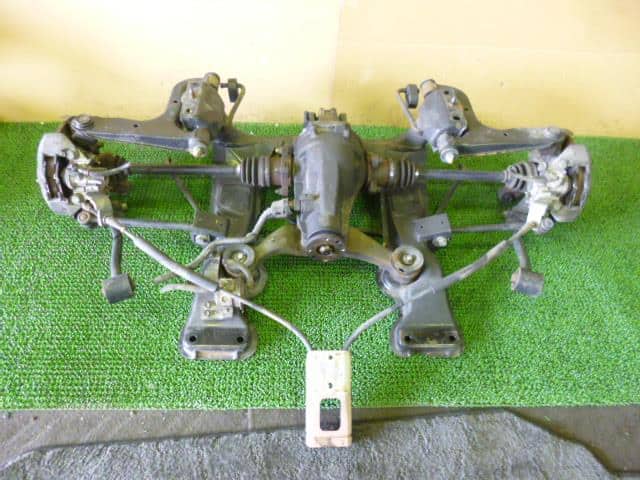

All the important bits are bolted to the subframes so it would be relatively easy to build.
While I hope the body repair works out, this sounds like a great scratch build. :)
I did a quick web search to see the Cappuccino chassis components, and they do look nice for integration with a custom tube frame, at least at the rear.
If building your own body and tubular steel frame, you might even be able to fit a small complete drive unit (motor with transaxle) into the rear.
