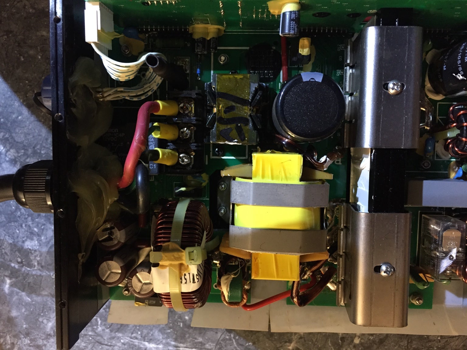

I have a 1.5 Kw 48v ElCon with hdw ver 1.5 that has stopped recognizing the attached battery pack. Flooded LA 280 Ah, 48v. Red-Green 1 second constant flashing signal after the algorithm count signal.
Doing basic troubleshooting I found that the 48v lines made it into the charger. Opening the case ( so many screws ) I find that the 2w resistor in series with the diode across the output relay has burned open. Diode is OK.
I jumpered in a replacement resistor and powered up but no success. Started tracing the circuits using these schematics but with the black and yellow goop it is hard to locate components and reliably contact their leads.
The yellow goop is tenacious, any tips on removal?
Others who have had this problem, what was the root cause? Did you have success at repair?

The resistors are across the input not the output. They are used as a bootstrap to start the 12 volt logic which then shuts the relay bypassing the resistors.
We have seen several of these where the 12 volts goes out and opens the relay which in turn burns up those resistors because they can't take the power for that long.
i've never seen that failure on the output side, but we have repaired a few that failed on the input side. The output relay is energized from the 12V power supply but the resistor-diode is across the output contacts.
The yellow goo will crumble and come off easily after it has been heated until it turns brown. A soldering iron can do it for small spots that you want cleared, or a heat gun can be used to hit large patches.
Good luck and keep us posted on what you find. kenny
The resistors are 150 ohms and could see 120 VRMS if there is a short anywhere on the 160V bus (or if the charger attempts to charge at a high current level into a low voltage battery. That would be 96 watts. There should be some way to disconnect the mains supply in case of a fault like this. The resistors are there to precharge the capacitors. For 1000 uF the two resistors in parallel (75 ohms) have a time constant of 75 mSec and full charge will be applied in 5 TC or 375 mSec. If you replace them with two 1000 ohm 20 watt resistors they will dissipate at most 14 watts each, and the TC will be 500 mSec, with full charge in 2.5 seconds. Seems reasonable to me. ;)

Oh, ok you guys are right. I forgot about that big resistor on the output. I don't believe we have seen that failure. It would be nice to see what the software is outputting. Did you recognize the flash sequence Mike.
