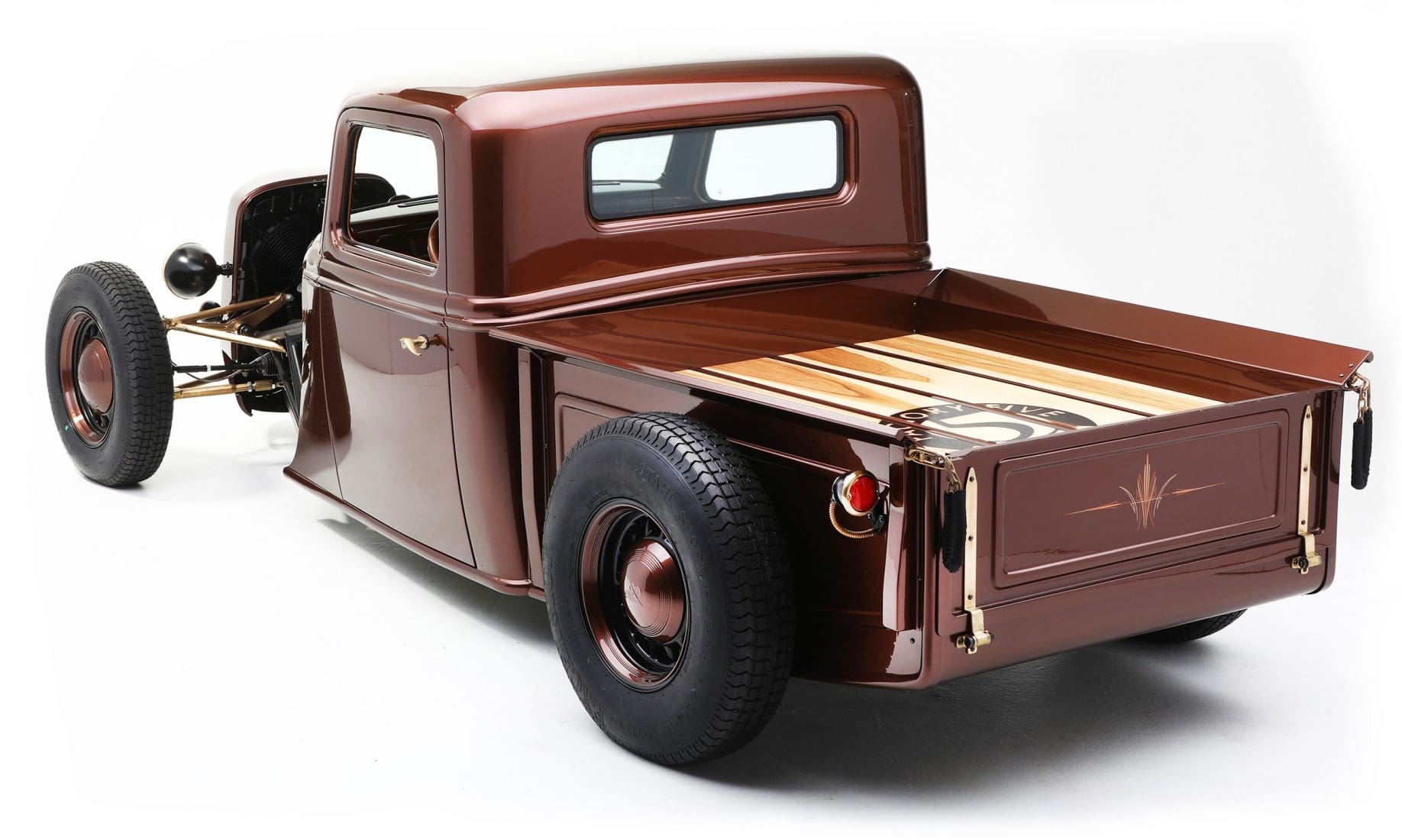

So my plan is to use 6 of the Tesla "Smart L-Ion" batteries (Tesla Smart Lithium Ion Battery 18650 EV Module - 57 Volt, 3kWh, EV West - Electric Vehicle Parts, Components, EVSE Charging Stations, Electric Car Conversion Kits) in series with a UQM-160 motor/controller (UQM-Danfoss PP160 Motor & Controller). What kind of miles am I going to get out of this setup?
The doner truck is a 1935 kit truck from Factory Five Racing. Still got lots to do, here's a picture of it in my driveway

Hey, I missed this post, but looks like a cool project! How far you will go depends a bit on how fast you want to get there :) Generally, the rule of thumb is to take 10% of the weight in lbs to get watt hours/mile. So if it weighs 2500lbs (I just made that number up), figure 250wh/m. Your pack would be about 18kwh, but figure you are only going to use 80% - so 14.4/.250 = 57.6 miles give or take. Going fast is going to take more energy, as aerodynamic drag dominates as you get up to freeway speeds.
What are the goals you had in mind for it?

Thank you for the response. I figured 6 in series to start, get all the kinks worked out and get everything working as it should. Drive around the block a couple times. Then add 1-2 more sets of 6 in parallel to get the distance.
Perfect numbers there, as the truck is about 2500 lbs. 50 miles on a charge will be great to start.
I'm curious... where are you planning to put the battery modules in this vehicle?
I'm in the process of building a Factory Five Racing 1935 Ford Truck. The current plan in to put the batteries in the bed.
The FFR truck is a lengthened version of their Hot Rod, and has a very high bed compared to the rest of the vehicle (which is kept as low as possible).
If you put just one layer of the Telsa/Smart modules in the bed and build a new structural floor over them, the new floor will be approximately to the top of the tailgate - you will have essentially built a flatbed instead of a pickup. Also, the mass of the battery will be very high (no higher than it would be in a conventional pickup, but very high for this vehicle), which is bad for handling.... although that doesn't seem to bother a lot of DIY EV conversion builders.
If that's what you're expecting and you're okay with it then great. :) I was wondering if you might have found some clever way to package the modules in another location.

You are correct, just going to use the top of the bed for batteries. The frame has alot of cross members keeping the use of storage to a minimal. I wish I could use the newer tesla batteries, but their voltages are too low since I need to get to 350V, I'd need like 16 of them just to get the voltage needed. That would definitely take up all the bed, and then some.
