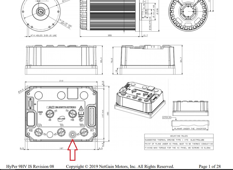

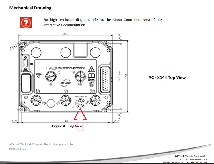

From Netgain manual:
From SME literature:

Hi Carl,

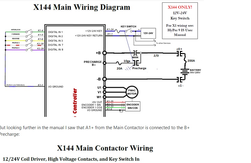

I am also in the progress of a Hyper9 build and I have the same Question. When I read the manual I was confused that Precharge is directly connected to the high Voltage of the Battery. I always thought this would be over a switched 12V Contactor source.
122114
But looking further in the manual I saw that A1+ from the Main Contactor is connected to the B+ Precharge:

Looking at the picture, though, A1+ is connected to battery positive - so they seem to be having us jump past the main contactor with a fused wire. This would leave high voltage power to the precharge terminal at all times. There is the somewhat cryptic note that for both precharge and B+ that "*This HV circuit should include proper fuses and disconnect switches."
I think what I am going to do is use a small contactor like this one:
That way I can keep HV off the controller unless the car is in the drive state. I have secondary contactors in my battery box, so I am skipping the emergency disconnect switch. I might add one if I ever need someone else to work on the truck for some reason, but if it is just me I dont really see the point. Anyway, here is what I am envisioning. I might touch base with Netgain and see what they have to say about it.
26 Posts
That was also my idea. Having a small contactor with key switch signal. But the question remains: why did they do it at Netgain or better SME? Hope to see the answer in this thread. I am not comfortable with any high voltage permanently at the controller.
Speaking from the X1 POV (not X144). My understanding is that the main gigavac contactor (supplied with the Hyper9 kit) is only activated once the controller has booted up and all controller systems are 'green'. There is a 5-10A fused high voltage supply K1-24 iirc switched by a relay ('Key Switch HV relay' below), on 'Key On' . This doesn't scare me and it is fused.
PLUS a benefit of hyper 9 is the voltage is relatively low ~120-144v vs most 400v AC systems.
