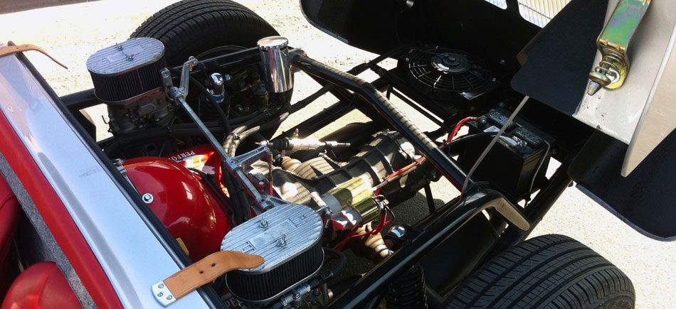

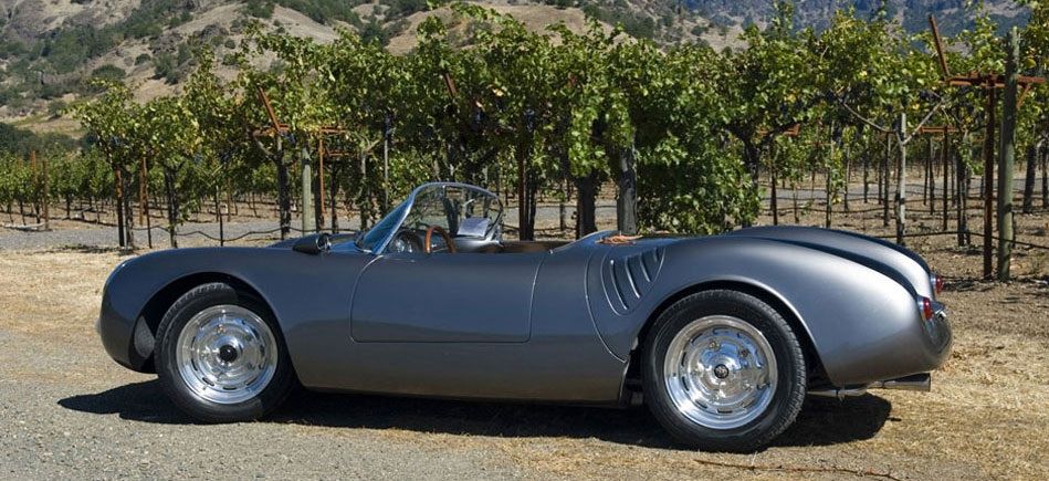

You may consider starting with a lightweight kit car. This could be the test bed for your luxury versions and simplify the build. They have more advantages because you are starting with a vehicle that has more options for component placement. Vintage Spyders has a 550 Porsche Spyder that weighs only 1300lbs. ready to drive with an owner installed VW drivetrain. You could build this car weighing less than 1500lbs.
www.vintagespyders.com
Check the photos of this Spyder Build years ago before the advent of Lithium.
http://www.ohler.com/ev/spyder/history.html
Check the little video and all the photos. I have the same motor in my Bug.
Looks like a Thunder Ranch chassis.
I have designed an all metal aluminum foam panel monocoque chassis, with 8mm panel thickness, to replace the tubular space frame chassis.
The complete chassis will only weigh 200lbs. and have 10 times the torsional rigidity of the tubular chassis.
The front suspension will have coil-over A-arms.
You may consider starting with a lightweight kit car. This could be the test bed for your luxury versions and simplify the build. They have more advantages because you are starting with a vehicle that has more options for component placement. Vintage Spyders has a 550 Porsche Spyder that weighs only 1300lbs. ready to drive with an owner installed VW drivetrain. You could build this car weighing less than 2500lbs.
Why would it weigh 2500lbs? - if it weighs 1300lbs in IC format I would hope to see it as an EV at a similar weight
Sorry.
My bad typo.
Should be 1500lbs.
Yes, its a Thunder Ranch Chassis and Body. It was modified by Thunder Ranch specific for the electric build.
