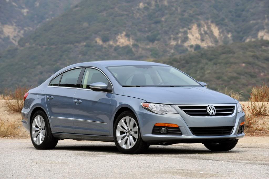

I really wanna do a VW CC to be honest...it has everything i could want in a car and also i can buy it with a salvage title and then use the parts for my current car. i have a black one and i know that i can get a lot of fun and pleasure out of driving it.....So lets say I go with that car..would that be alright to do and make it electric
Since you have one you can do some checking on space for batteries. Its best to not put them in the passenger compartment. Best under behind and up front around the motor. You'd then need to figure out your motor/controller setup and maybe a voltage range. That would need a reasonable sized motor. Mostly for torque. The AC-75 is an affordable motor. The curtis controller can be set to utilize an automatic by doing idle. You might call up HPEVS and run it by them to see what they think. They also have a dual AC-35 which if you have the room would be a kicker motor setup. Might consider dual motors stacked if possible. Would require a custom adaptor plate. But would give a kicker vehicle. There are a few dual stacked motor setups around.

VW CC

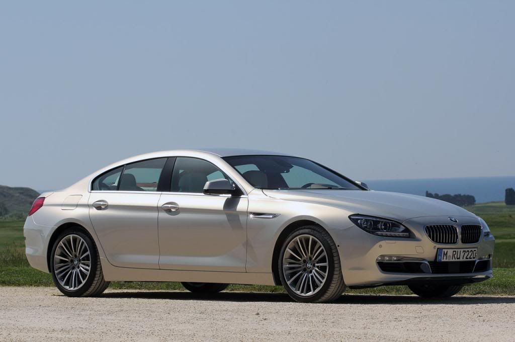

BMW Gran coupe

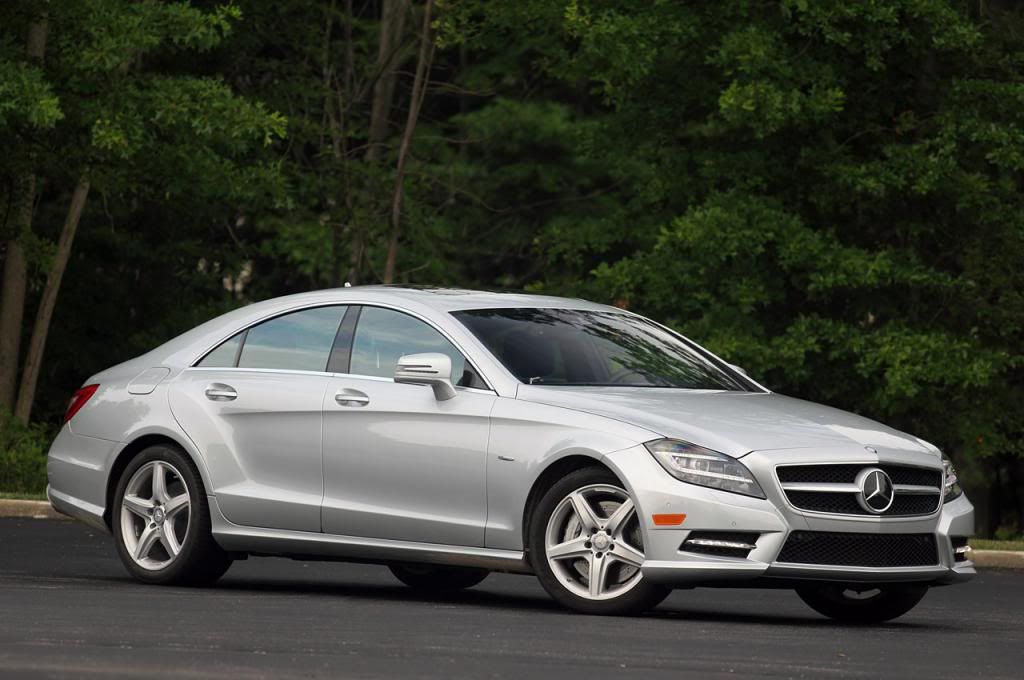

Mercedes Benz CLS

Lovely cars!
But all of them will be massively under powered with an AC75 - 80hp
You will need twice that for a car of that class
