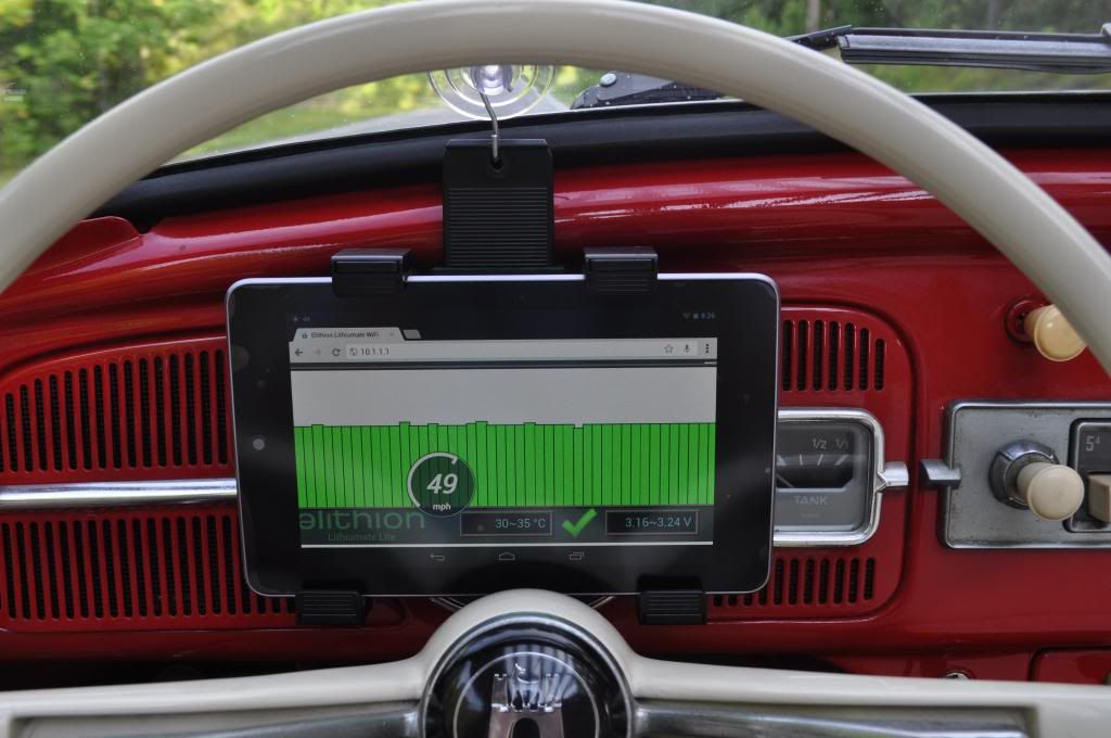

Finally got around to taking pics of my newest conversion, my 1961 VW Bug. I restored the car 15 years ago and had put 19,000 miles on it as a gasser. After converting 5 different vehicles with high school students at Topsail High, I decided to have my Bug converted to full electric. The conversion was secretly completed ahead of schedule by my students in time for my 50th birthday. They surprised me by driving it to my house on my birthday! What a great present.
As for the details, Advanced DC 9", Synkromotive controller, 44 Thundersky 100aH cells, Elithion Lite BMS, Elcon PFC 1500 charger, and an Iota 45 amp DC/DC. I went clutchless to the VW tranny. Instrumentation will be provided by a Nexus 7 using the Elithion BMS Wifi unit and the Ulysse Speedometer app.

Pics of the dash display added. I have installed the Elithion WIFI unit which displays pack info on any browser screen. I also am running the Ulysse Speedometer App for speed, average speed and trip meters. The cool thing is the overlay feature that will disply the speed on top of the browser window.
