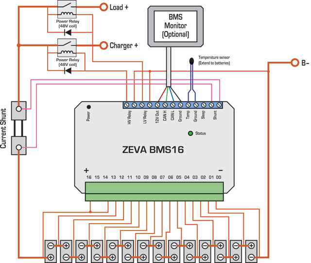

I don't think that diagram proves what you think it proves...You are mistaken. Many BMSes intended for use in high current applications have specific port(s) for connecting charge/discharge contactors. Here is a wiring diagram for Zeva BMS16, with two separate contactors clearly visible :
http://www.zeva.com.au/Products/images_lge/BMS16v2_Example.jpg
You are technically correct here, you just misunderstood what I was saying. The question of current is only relevant to the way BMS may be switching load/charger on/off. Many low current BMSes do that by means of on-board MOSFETs. Since it is impractical to use solid state devices as switches in high current applications, BMSes meant for high current applications rely on contactors, while providing control interfaces for those contactors.I don't think that diagram proves what you think it proves...
The discharge current is not under the control of the BMS normally. The controller throttles that and keeps it within limits. This diagram shows the BMS controlling the main contactor (to open it if a cell is low) and a charge contactor (to prevent overcharging). Neither of those are concerned with discharge amperage. The only reason it has a shunt is for state of charge calculation, probably. That's all my Zeva does with the current sensor.

That is EXACTLY what I saidYou are mistaken. Many BMSes intended for use in high current applications have specific port(s) for connecting charge/discharge contactors. Here is a wiring diagram for Zeva BMS16, with two separate contactors clearly visible :
Except you saidThat is EXACTLY what I said
The BMS does NOT control the current in either situation but it does effectively tell the charger or the controller to STOP
Which I explained it often can't do, as there there may be no integration between the BMS and the charger.But it will NOT shut off the charger - it will instead instruct the charger to shut off

ZEVA can communicate with several chargers via canbus or by triggering an enable relay. I even used a TC charger and ZEVA was able to set the charge parameters over canbus.
The type of BMS that the OP is referring to actually pushes all power through the BMS, hence his question of how large he should go. I don t see any reason to use a BMS like that in this application, even if they have one that is robust enough for it.
