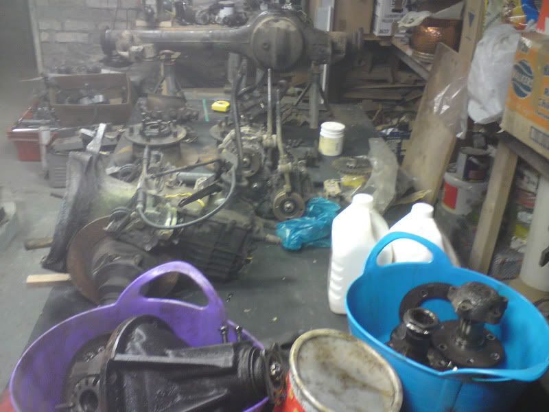

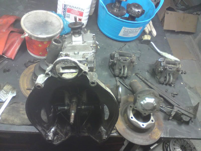

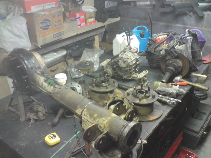

Jim, I'm just playing, I miss playing with automotive bits but I am more used to playing with huge automotive bits. I have culture shock!:D
A basic compact tractor, even non running, would cost quite a bit more then I have spent so far.
Anyway, photos.
Just a quick shot from each end of the bench.
Stripped down axle, transfer box, 2CV box, buckets of bits.

Woody,
WOW how to you keep your bench so clean:D
Mine hasen't been that organised in years.:eek:

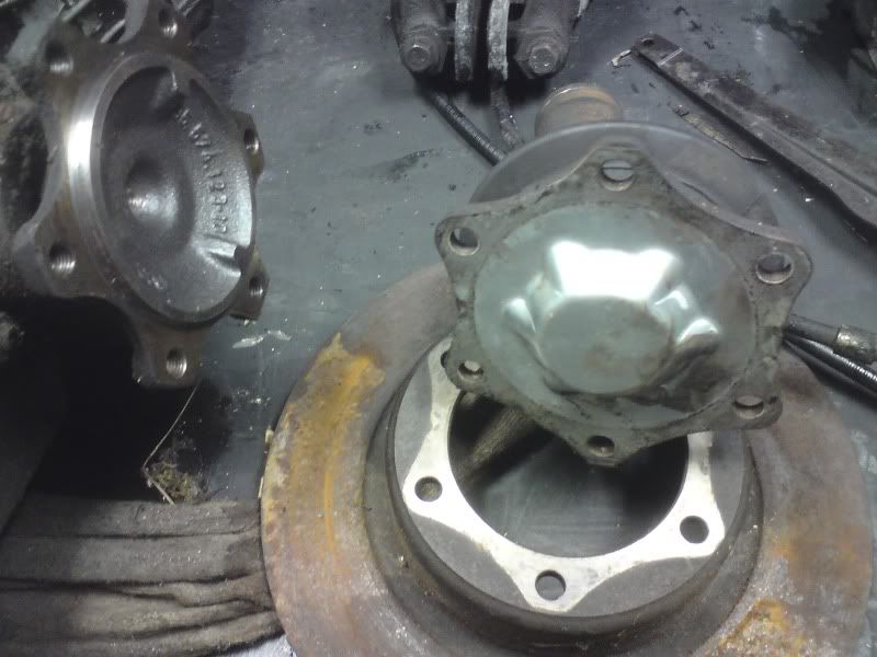

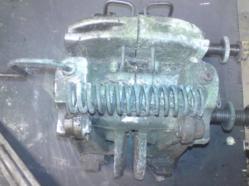

I've started to clean the 2CV box and have removed the brake calipers, discs and driveshafts.
The calipers are an odd design. The fixing bolts also hold the two sides of the caliper together. So once it is removed it falls apart pushed open by the handbrake/parking brake caliper spring.
Interesting that the drive flange has a locating ring on it but it only locates and centralises the disc. The drive shaft CV joint is only located and centralised by the bolts alone. I guess they had better be a snug fit.:D

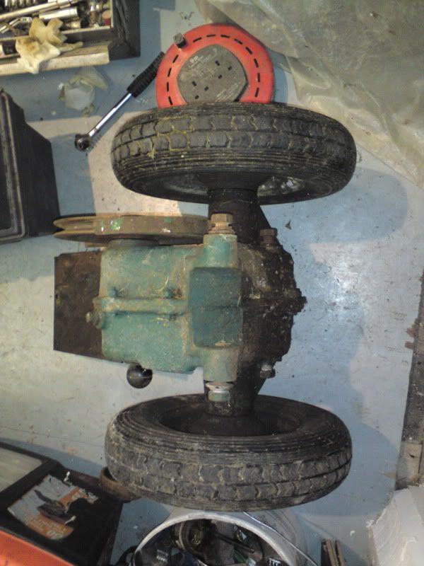

I seem to be collecting a lot of cheap mechanical bits.
The latest find is this:
It is the back end of a Ransomes vergecutter and it gives me a two speed transaxle with wheels and hubs and a mount for the motor. The front end has four bolts that will allow a simple front end to be bolted on to take steering and batteries. The ratios are approximately 8.5:1 and 16:1 plus around 3:1 to 4:1 on the pulley.
Now I stop looking and start building, all the other bits will be back on Ebay so I can get some batteries.
The motor will be interchangable from this project to the MR2 to get the MR2 road legal.
1,199 Posts
