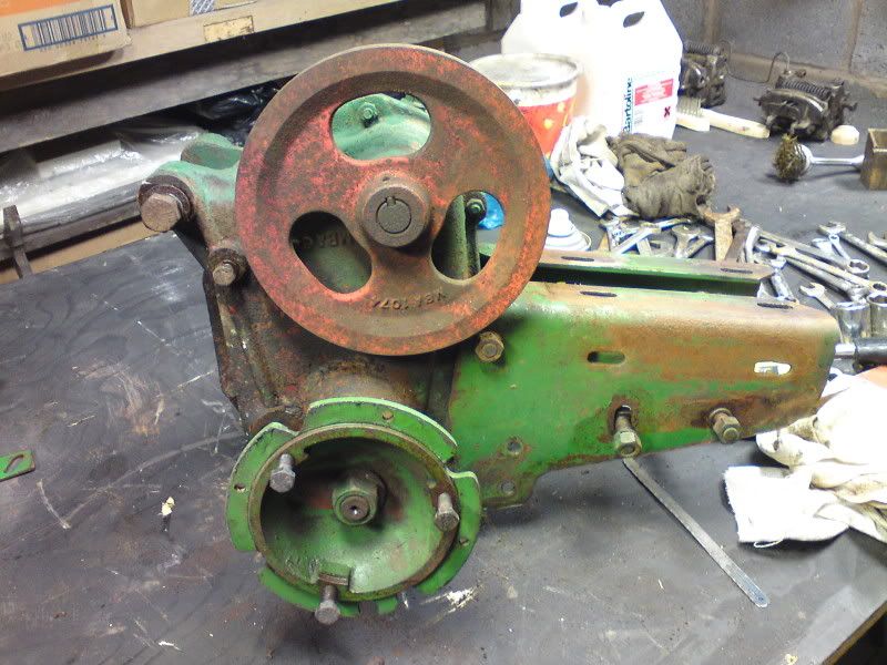

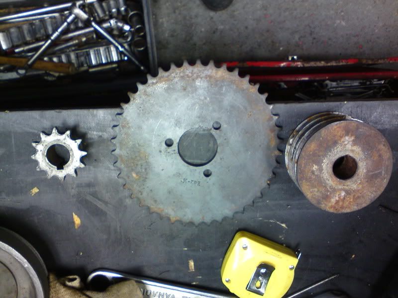

Have any kind of brakes? No, But I was thinking of a transmission brake on the drive pulley or use the plug braking of the controller.
The pully in the picture looks like it has a couple of surfaces the you could make a nice disc type brake work on.

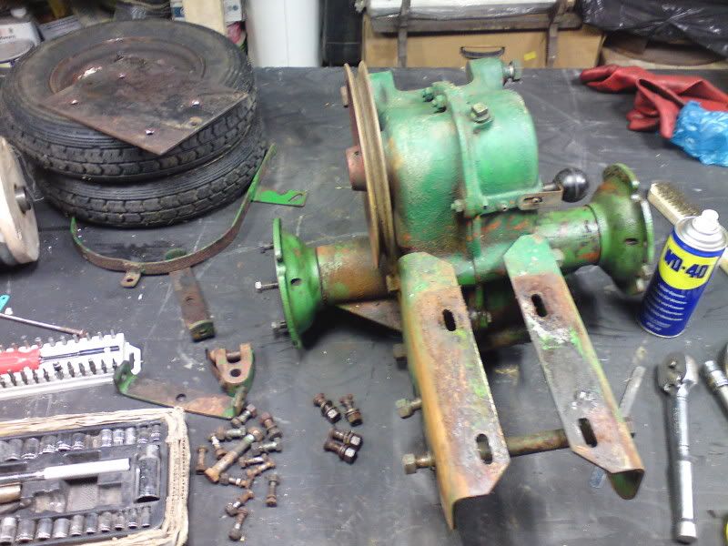

In between waxing my table I have been in the workshop stripping and cleaning the axle.
The hubs have one set of four clearance holes that will take M6 bolts and three threaded holes that take some UNC bolts. They are very hefty.

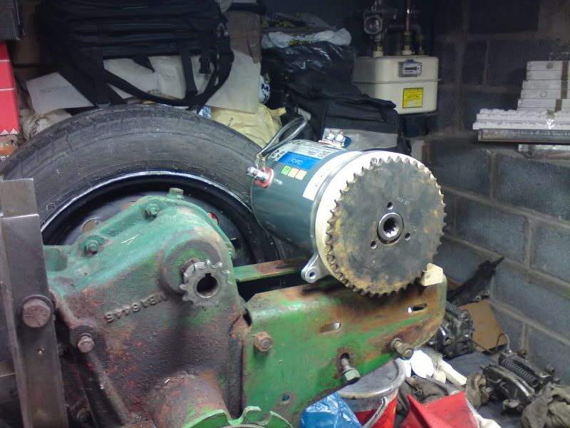

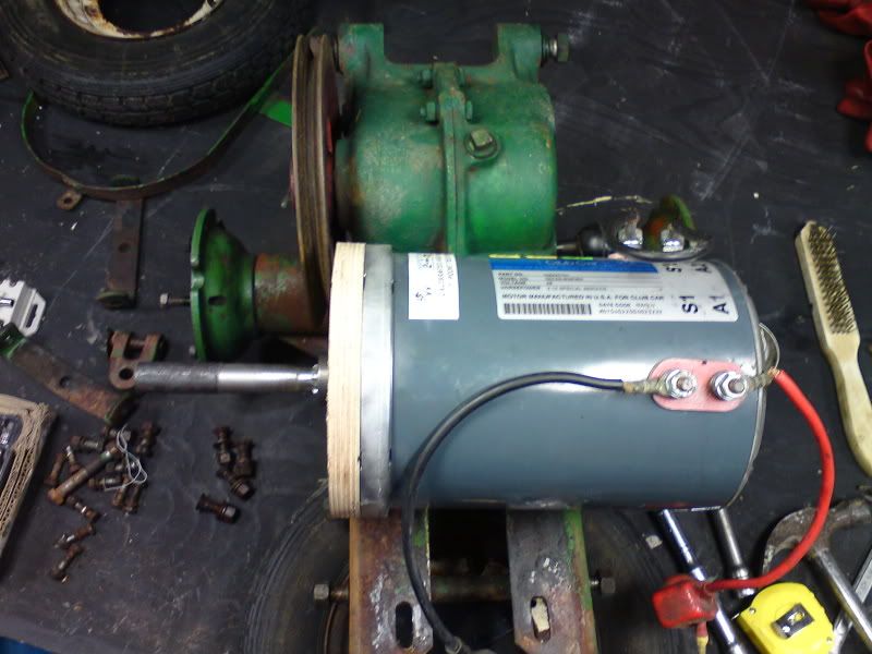

The motor is a little wide to line up easily.
I will have to move the big driven pulley outwards somehow so that the motor is more central.

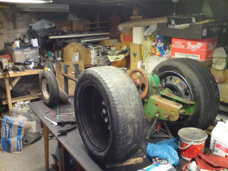

I have put the axle on stands to get an idea of layout and proportions.
As it stands the wheel base is around 44" and flexible. The axle stands are a little high giving a 25" effective wheel diameter off the bench but it is close enough to do for now.

A thought on motor alignment. Maybe a jackshaft or a 1 to 1 right angle drive?

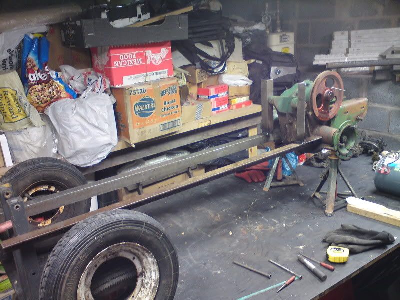

That's great, I can make an axle from some 70mm x 50mm x 3mm box section.
I will have a look for other battery options but I am doubling or trippling the cost with conventional deep cycle ones that are also big enough for the car. I am only expecting the car to move enough to be tested and made legal.
I was thinking of a right angle drive for the motor while I was working on it. I will need to see what I can find. There was a pile of worm and wheel gearboxes at the scrap yard but I ignored them last week as there was too much mangled machinery around them. Probably too much reduction anyway.:D
I started on the frame for the TT.
I had some 40mm x 5mm angle from the scrap metal yard so I used that to for the bottom part of the frame. It is a bit small but it will do as a start and I will make a top frame over the batteries and then brace the whole thing into a girder bridge. If I can find some 50 or 60mm angle that would be better.
I need the TT to be CKD so that I can get it back off the bench and out of the basement so the four bolt attachment to the axle is really good.

A thought on the pully. It looks like it is keyed and pinned to the shaft. could you drive out the pin and turn the pully around so the snout is towards the gearbox then redrill and repin it. That looks like it would give you another inch.
Looking at the rear hubs with the three bolts. I remember seeing some French vehicles that used a three bolt pattern. Any chance they are the same?
On the front wheels make some spoked hubs and bolt them into the 4 bolt holes. Get some tubing that will comtain 3/4 inch ID bearings or bushings and make spokes from flat stock, Weld them to the hub on an angle then bolt or weld them to the wheel. Made a rear wheel for a Motorcycle Ice Racer with side car like that once. Used an old steel hub from a something motorcycle (can't remember) and a 15 inch car rim we had cut the center out of. We had the widest tire out there. This was back in the days when a 4 inch Harley rim and tire was the widest thing out there.

Yes the pulley is keyed and I am soaking it in WD40 to get the set screw out. Reversed it will give about an inch but I would like 3". I may make up a shaft extension for it and just move it out where it fits best.

So today I popped into a car breakers to find a couple of steel rims to use for the back of the TT. The intention was to get 16"x6" ish as I have a couple of old tyres from my car that would do as good slicks to start with. Also using 16" rims would allow me to use Land Rover off road tyres or dumper truck tyres. The chap pointed me to a skip full of old rims and told me to find what I wanted from the scrap. I found a couple of 16" x 6.5" steel wheel rims that felt a bit light but had a lot of offset to widen the track a bit. £5 the pair so I had them and left. They were aluminium with electronic pressure sensors on the valves. Not sure what car they were from but they will do.
So this is where we are at now with the tyres on the rims:
I will make some spacers to make them fit and then use then inside out.

I got the big pulley off this afternoon and had a play with bits I had that might fit the shaft. I came up with this for race gearing!:D Funny how the little sprocket was a perfect fit including keyway!
I also found a triple pulley block that fitted the shaft so I just need to open the keyway a bit to use it. I figured that I could machine it and use it to mount the bigger chain sprocket and then fit the small one on the motor shaft and then house the whole thing in a chain case that allows for bearings both sides of the sprockets and for tensioning and safety.
The input drive shaft can then stay in place while the motor is pulled for the car.
The tooth count is 12 and 42 so there will be a good reduction to allow for higher motor speeds.
Image seems to be upside down, not sure what Photobucket is playing at.
Looks like you have things in hand. A idea if you use the triple pully and if your trans has a neutral you might consider a power take off i.e. another pully and shaft with a slip belt clutch.
Now there's an idea!:)
