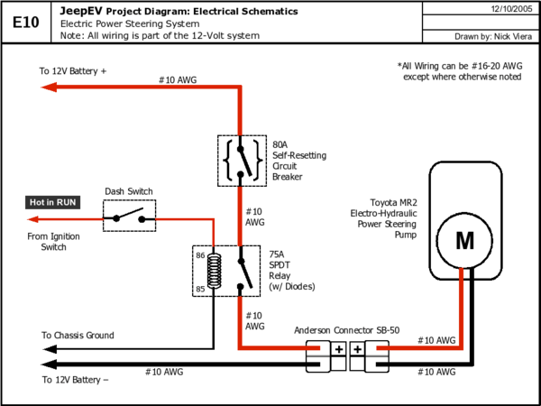

Hi Old.DSMer,Keep us posted on your results,we have been searching and evaluating EHPS systems on the thread Power Steering Solutions to find systems that will install simply onto an EV.
The ones that convert the best so far and have written & photo proof are Toyota M2R,Astra/vauxhall/Opel TS, The Earlier Mazda 3 systems also have evidence to show that they will work but apparently need an alternator to sense off,the same is partially true for the Astra/Vauxhall unit.The units to purchase are : M2R with attatched resevoir,Astra unit with flat bottom(no cooling fins) ,the later MK4 units will work and are wired the same but are more dependant on having an alternator - Wiring is Blue white wire to alternator charge light pole,Thin black wire feed from ign switch,thick red wire battery positive thru an 80amp self resetting circuit breaker, Thick black wire battery negative. Apart from the sensors I think the biggest problem is that the later units need the alternator connection to operate, All the evidence we have gathered seems to point to this. Find wiring for the M2R(astra as well just add the alternator connection) here:http://www.diyelectriccar.com/forums/picture.php?albumid=266&pictureid=1741

Hi Old.DSMer,The M2r units arn't really that expensive usually $200 to $300, about half the price of some EV conversion/parts firms. The early previous to and including some 2007 models work stand alone and from what I have picked up from around the traps is that quite a lot of them will work if connected to an alternator,quite often not used on an EV but in light of my discoveries maybe they should be as the drag would be far out wayed by the usefullness. The early Astra unit can be obtained from $40 many people quoted this price. Both of these unit don't run at full power but start up run for a few secs and then drop back to an idle mode and pick up when sensing load, the M2R unit has a self contained procesor which can be linked to the alternator to shut it down when the motor stops and speed sensors etc, (but all of this was worked thru on the P/S Solutions page),how much would an ehps + the controller you spoke of cost relative to the cost of thr M2R unit + simplicity of installation.
