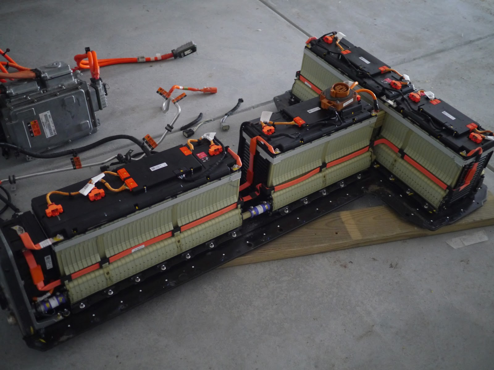

I actually bought the entire EV drivetrain from a 2013 Chevy volt with 7k miles. After 3 attempts of buying a new volt battery (paying for, waiting months, and then getting a refund from the dealer) I just went with a scrapyard unit. A few weeks ago I started tearing apart the Chevy volt pack and video taped the tear down and here are the links:

Here is the engine side of the gear box. And on the bottom you can also see where the passenger side axle shaft comes out:​
The Volt pack has a disconnect mounted on top. It is not the easiest to pull but I am pretty sure it is fused.​
The pack cover is easily removed and the the whole pack is easy and straight forward to work on.​
The pack is configured in 3 modules that are made up of 48V and 24V modules. The pack measured 370VDC total and is likely near a "full" charge. Keep in mind that chevy's version of a full charge is actually 80% SOC.​
I took video of the whole process and will post it up on youtube once I get it all edited. The modules are pretty easy to breakdown and I will upload the pics from that process next week.​

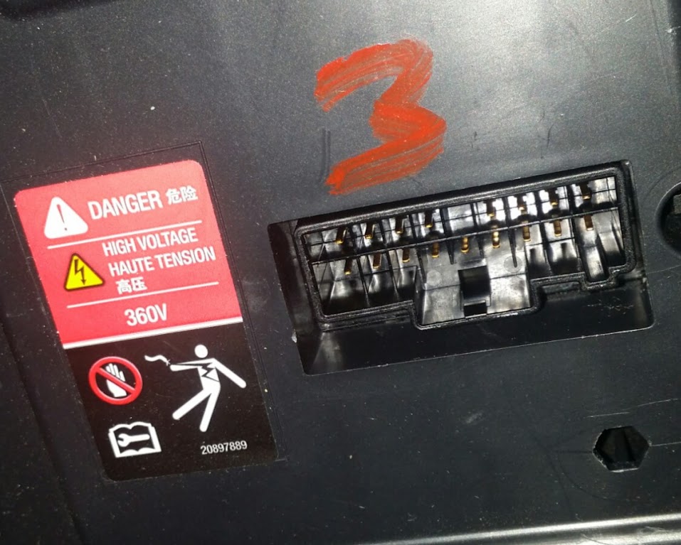

As far as the BMS, I know there are some on the forum looking at making the OEM BMS work which would be very cool but in the mean time I want to wire it to my Orion. With the right harness it should be a simple plug and play from the Orion to the individual modules. I have been talking to a few people about buying a harness (including Andrew at Orion) but nobody makes this so I am designing up my own.
#7 ·
I'm guessing you have yours apart so you've seen the Orange bms tie points. Just whack the control board side off and add your own connection scheme. Just unplug them from battery first as I believe they are live. Should even be a standard spec connector.
Yep. That certainly is an option. Ideally a cable could be made available that would allow anyone to plug straight from the modules to the Orion without even picking up a wire crimper.
I have been searching for a connector but in the mean time I could just depin the original connector a repin it.
Here are pictures of the 6 and 12 modules.
Also I forgot to mention that there is a current sensor located in between the front and middle modules

You could actually do that pretty easily. There are 7 of the 48v modules and 2 24V modules. They can be reconfigured into 2 192V packs (or 4 packs depending how it will be cooled) in parallel. The design of the modules will not handle high currents but putting in parallel will double the current and get you the voltage you need.

- The big ceramic white resistors are not heaters, they are precharge resistors. They are used together with a precharge relay (one of the small relays) and a MOSFET PWM, to ramp up the voltage before the main contactor turns on (so you don't get any sparking).
- One of the water connectors contains a HV heater (working from a pack voltage), again, controlled by one MOSFET
- All precharge, heater and contactors can be controlled externally, not using BMS module (it does not interface to it at all). Using X1 and X2 external connectors
I did reverse engineer most of the Chevy Volt drivetrain, but I'm still analyzing bits here and there, so I didn't want to release an incomplete documentation. Write me a PM if you want to cooperate on it.

Heater is in the passenger side water cooling manifold. 2 pin Orange connector going to relay module ( I think, mine is scattered).
Relays are good for average 10 amps on the small, 350-400 amps on the big mains, 600ish break on a one shot over current event. Nice panasonic hydrogen suppressed contacts which disassemble using a torx
Flat oem wires good (so far) 250 amp. I got nervous and yanked them.
Current sensor between module 1 & 2 is a 2 part hall sensor good to 400 amps or 20 amps. Rubber center plug. Offset is 3.80, voltage declines to 0. I am running it on 5 vdc, goes to 12. Building an inverted opamp to drive my jdh 404.
